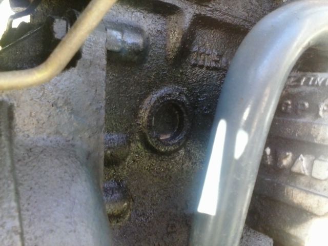

Coach, show us a picture of where the leaking plug is located.
If the cooling system is holding pressure it does indicate it is sealed and not leaking.
Is there a scored place where the leak is? Did you insert the correct freeze plug?
Maybe you could get by with one of those rubber plugs with the wing nut to tighten it up for at least a while.
22mm freeze plug is what is called for and what used.
plug location is just to rear of the IP area on the block.... kind of hard to get too and no way to look and see if block is scored. There is a steel hydraulic line in the way.
will try to get pic

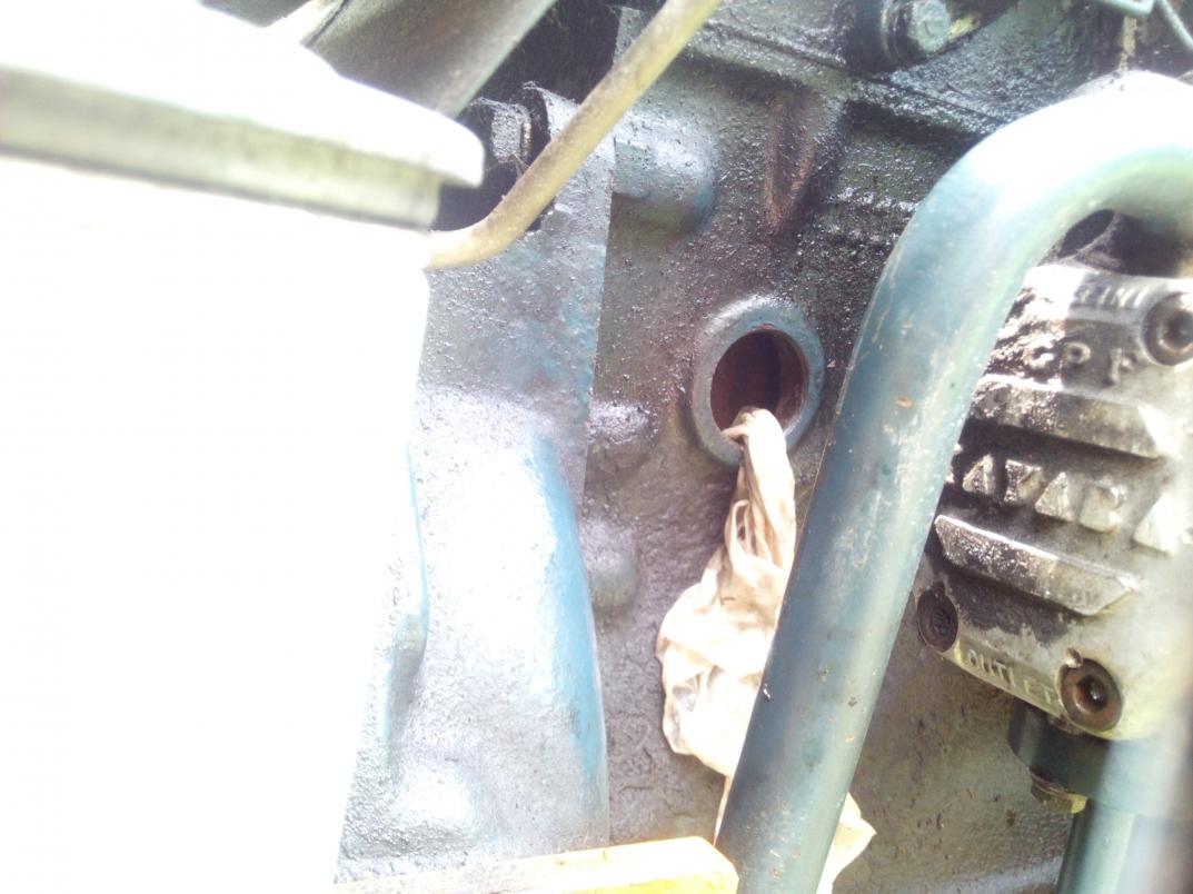

before and after pic. had a before pic from when discussing a block heater. Paper Towel is in there to transfer little more coolant out so level is lower and can then reinstall with no coolant in the area. Going to slap it thick with the sealant this time. Used light coating last time.

IMHO this freeze plug is not tight enough tolerance. Goes in too easy. Will see. going to wait 24hours for the sealant to do its thing

If you've already inserted the plug once, leaked, pulled it added more sealant and tried to reuse it, it won't seal, freeze plugs are only good for one use. ;)
Also If your driving it in using the center of the plug that will cause it to not seal also.

So far so good. Before reading in here that the new freeze plug once put in and pulled back off could not be re-used..... I had already put it back in with more sealant around it.
tadaaaaaa........ it does not leak when pumped to 13lb of pressure. I believe the engine is 12lb?
here is my thoughts.....
. I suspect it will leak again at some point so I will watch it.
. there are several 22mm (equivalent) plugs... @ Oriely's all are a hair over 22.0
... the largest being 22.41.
... suspect this one ended up with was the 22.17 due to the loose fit in the first place.
...... no way could have deformed it pushing it in the first time by tapping it in with tool in middle and not on edges. it went in wayyy to easy for that. Probably why it worked just ok the second time, but with more sealant.
..... alternative plan in mind for shitz and grinz.. if this one had leaked again before going to get a rubber expanding one.. was to take NIW thought and reverse it... if taping it in could distort/pull edges inward..... was going to lay on a sheet of metal on the ground and whack it from the back side once to expand it the opposite direction.. maybe even making it a bit tighter lol.. didn't get to experiment with that though since she is holding now.
