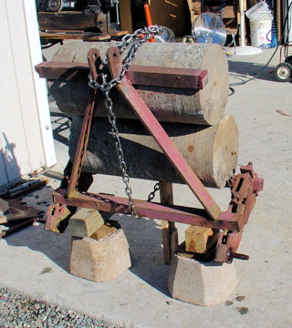

Good idea! I use a box blade with about 500 lbs added. Or a deal I made to skid logs with, which will also take a bunch of old wheel weights. Even a bush hog is better than nothing.

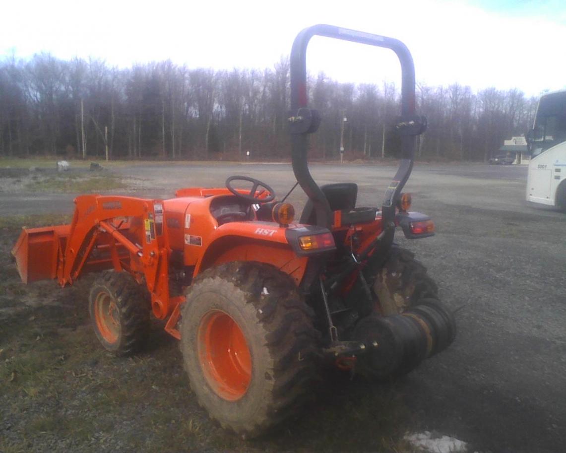

What a difference loading the back made !!!
The tractor moves like a completely different animal.

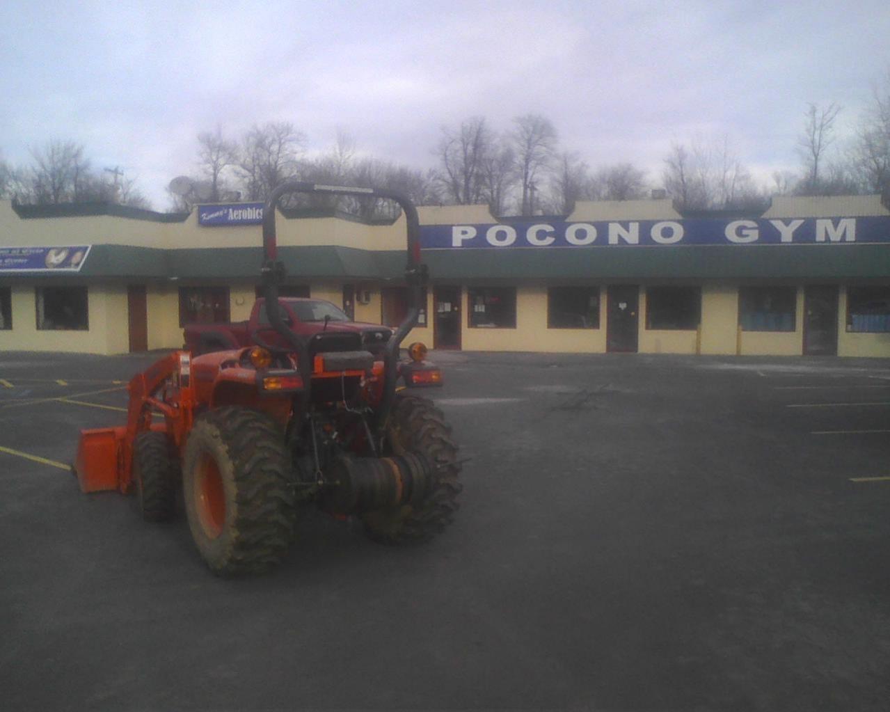

I own the gym in the picture and had a lot of extra 25 lb plates and some 50 lb'ers. I bought a 3/4 solid bar from Tractor Supply and some collars to lock in the plates. I ran the bar through the loading arms and loaded the plates.
475 lbs and room for more if needed!
Since taking the picture this afternoon I have since re-balanced the weight on the bar so that there is 150 lb on the outside of the lift arms so the bar will not bend as much.
Does it make a difference if I lower the lift arms and rest the weight on the ground when I am not using the tractor? Does it stress the tractor to keep the arms in a high position with the weight on? Or will the arms fall slowly on their own over night? Thanks
