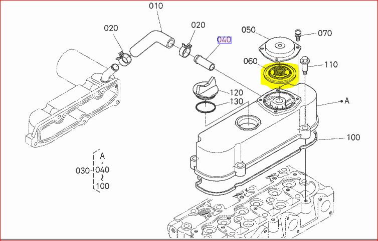

36,353
11,166
I should have asked hours, leaking injector with that low of hours wouldn't make sense, so I retract that thought.
I would still check the return fuel line for blockage.
If there is moisture inside the engine I would check the valve cover breather, if it's plugged or restricted that would cause issues.
That engines breather setup is a little different than the tractors breather setup, instead of the crank case having a fee flow of air out of the valve cover to get rid of excess gases and moisture it uses a valve.
That valve have been giving all Kubotas fits with the cold weather.
They are freezing closed and causing many an issue.
I would pull it and check/replace it.
Check with your local dealer as some are even under an update/recall status.
Changing the oil will help if there is moisture in it, but it's not going to eliminate the problem, fixing the breather will fix the problem.
