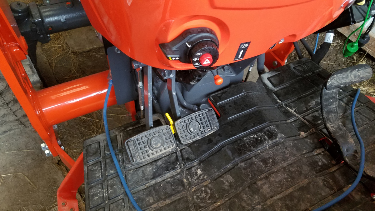

Actually, just about any tractor (not BX) has individual brakes, sometimes called steering brakes.
If your tractor has individual left and right brake pedals (it does), it has steering brakes. If the front wheels slide when attempting to turn, simply apply the brake lightly on the side to which you wish to turn. Experiment a bit at slow speed to get the knack of it.
There is nothing wrong with trying your tractor/mower combination before buying front weights, just be careful when lifting the mower, especially when going up hill. Be advised, that installation of front weights will require removal of the FEL. Many folks simply leave the FEL in place, usually removing the bucket, while mowing to add weight to the front of the tractor. Front weights are expensive. Might want to experiment a bit first.

Well that's embarrasing! :oops: The sales rep told me that I could separate the two pedals but didn't mention that the brake pedals were independent and I didn't bother to think about why you'd want to do that. As you mentioned, my little BX only has one brake pedal. I'm learning every day on this forum.
I want to run around with the bucket close to the deck to "catch" obstructions so will I not be able to do that with front weights? I'm not understanding why the FEL has to be removed to install front weights or why the bucket has to be removed. I'll Google Kubota and front end weights.

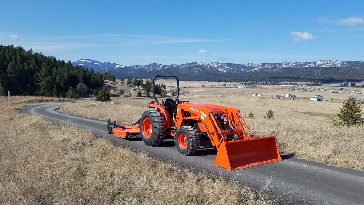

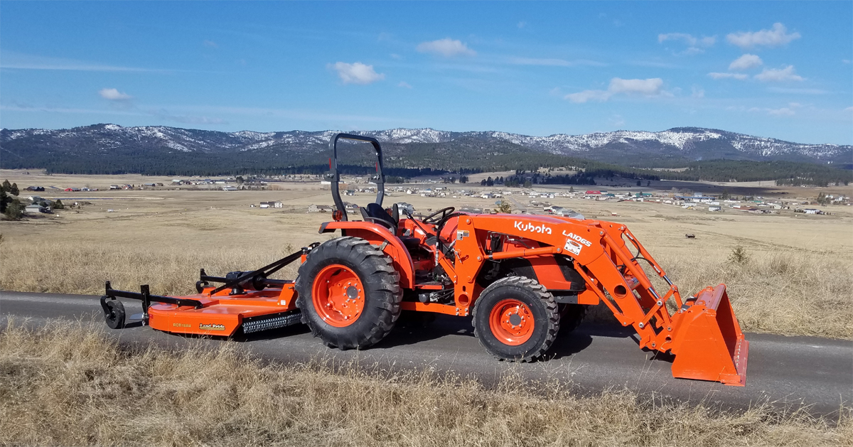

The beast is back! The third rear remote is installed. I've been reading the manual and learning how to set up the cutter. It's a big cutter but the MX seems to handle the weight without any trouble, and the FEL seems to keep the front down. Here are a few photos to give a better idea of the size.
I need to find a way to level the Quick Hitch with the top-n-tilt and mark the position ... at least, I think I do.

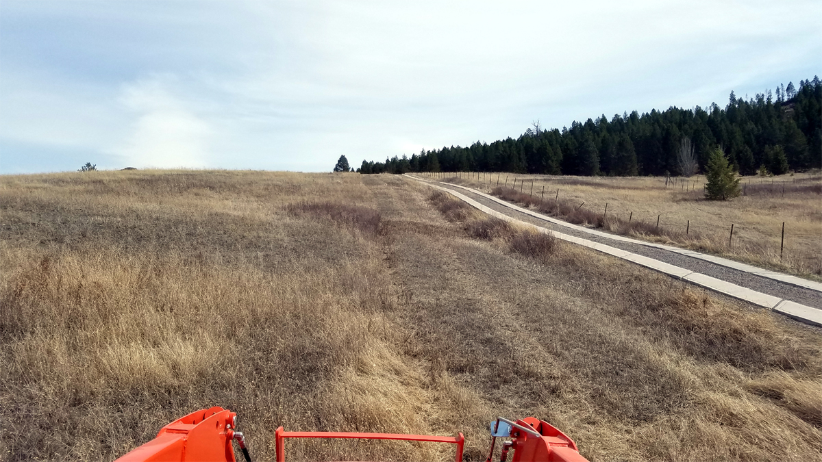

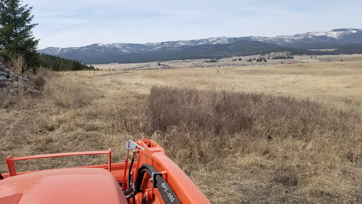

Final update on my rotary cutter saga:
Thanks to all who steered me towards a rotary cutter and away from a grooming mower, particularly @SDT . I set up the rotary cutter this morning with about 6-1/2" cut height at the front and 7-1/2" at the rear and took it for a spin! Dust and grass cuttings aside it's a lot of fun running up and down the field on the MX. I can see that this set up is going to work well but it's definitely not a couple of hours work. It's exciting that I'm finally able to take care of this field. I hope to spray it for weeds at some point this year.
The MX easily handles the weight of the cutter and seems to soak up the uneven terrain without issue. Once I've done the entire 15 or so acres and located or removed major obstacles I might be able to lower the cutter an inch or two. I've been using the bucket to cut and remove mounds of dirt as I encounter them. These mounds were created by various critters but the bucket seems to work well for this.
