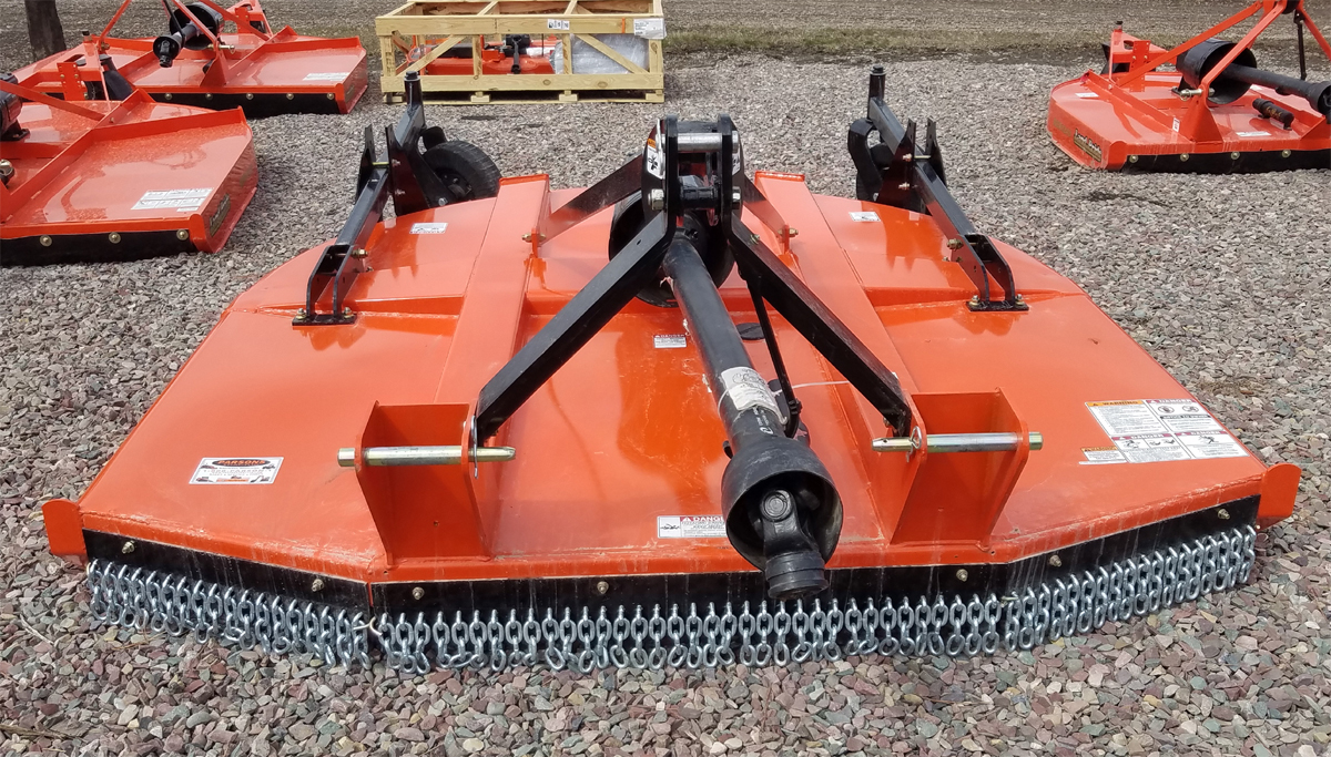

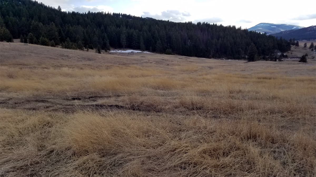

Here's the RCR1884 that I bought and that won't be going back. I'm hoping that I can get an area south of the new barn nice enough and smooth enough that I'll enjoy mowing it with the BX. I plan on beating everything else into submission with this beast. My neighbors have about 3 acres of their 22 acres that is very overgrown and they've already indicated that they'd happily pay me to get it back under control.
You can see the RCR1272s in the background that are dwarfed by the 1884.

I think this is a better overall decision than the finish mower. Your MX6000 will handle this well.
I use a Woods BB720X on my MX5800, I believe the cutter weighs 1,100 lbs and only has one rear wheel. I feel that I have plenty of HP even when cutting waist high grass.
Your RCR 1884 weighs around 850lbs and had 2 rear wheels which is a nice feature for the wider cutter. I think you will have no HP issues and you just have to match your cutting speed to the material you are cutting.
Once you have had 10 minutes with it you will figure out the best travel speed. It looks a nice cutter, I like the chain guards front and back. It will work well over your bumpy ground that you have described. Good luck with it, give us some feedback after you have had some time with it.

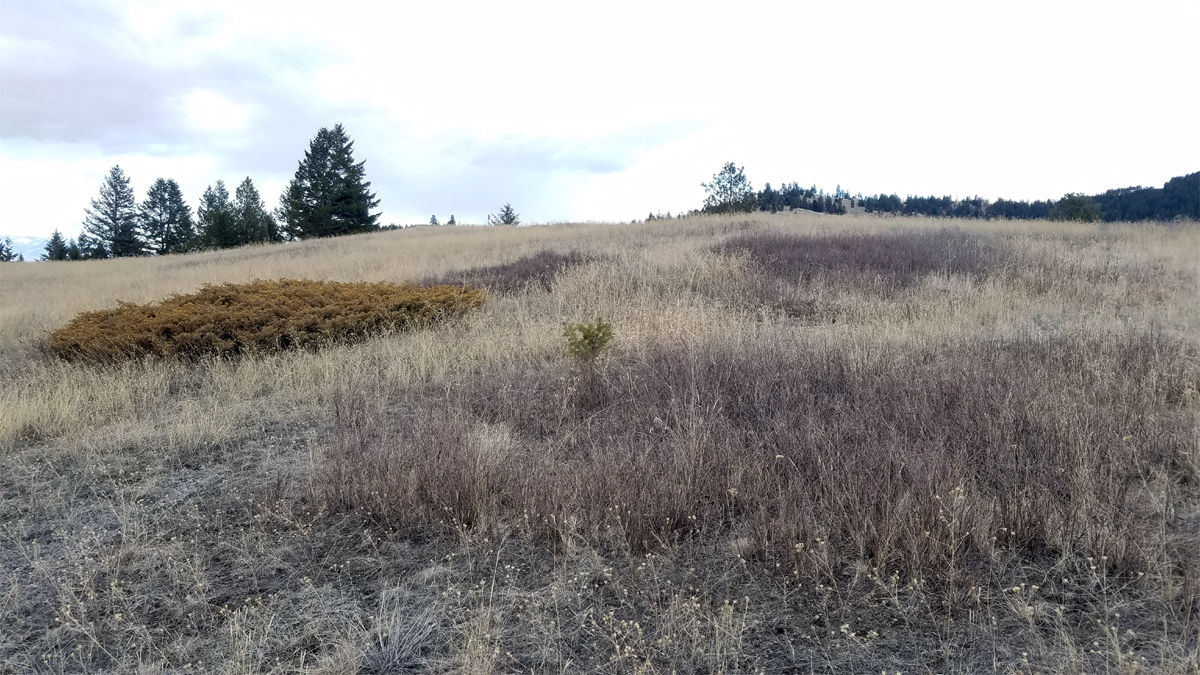

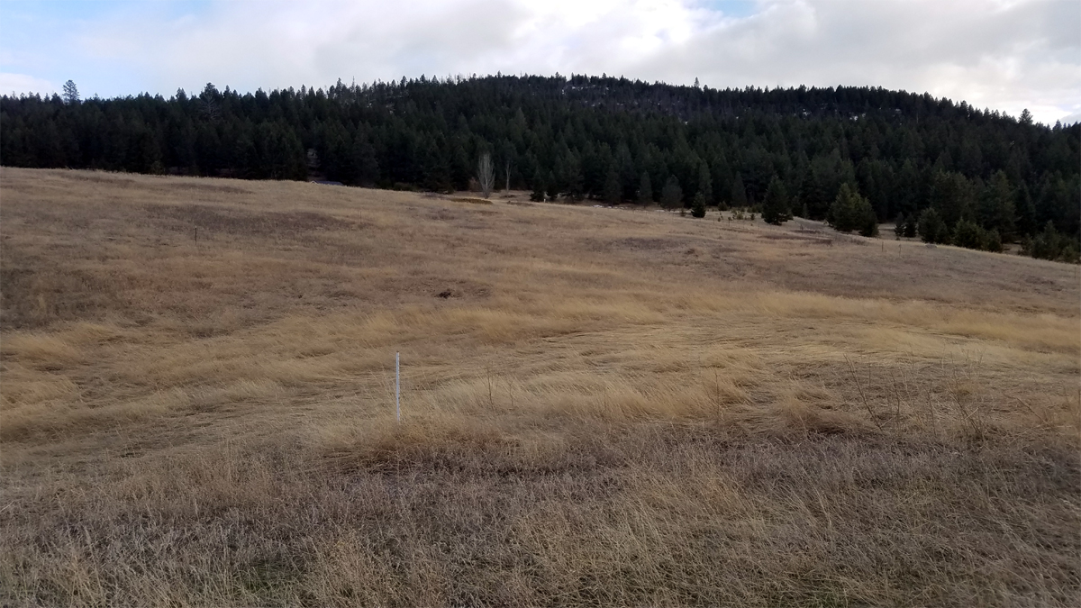

The 7' light weight rough cut mower is a much better fit for your ground than is the finish mower and should hold up well, and at only 850 Lbs., you may not need front weights even though the 7' cutters are long.
Though 7' is a large rough cut mower for a 53 PTO HP tractor, your HST transmission allows you to mow at whatever speed you desire. Mowing speed will be determined by what it is that you are cutting. Weeds/brush cut easily, whereas, thick grass sucks HP. If you keep the blades sharp, the mower will cut better and require less HP and fuel.

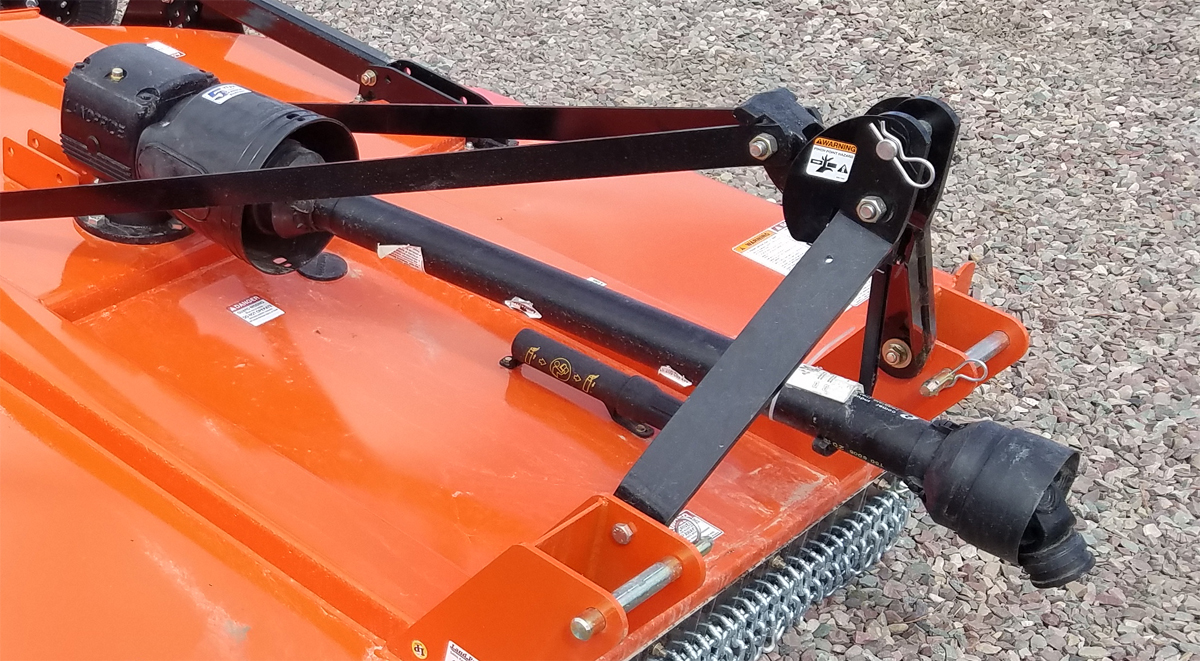

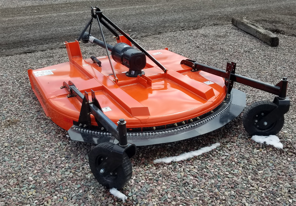

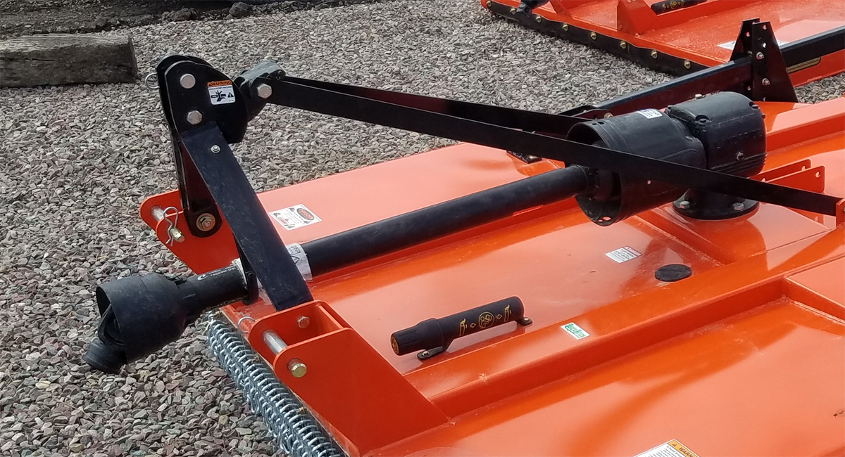

Yes, there's a link that allows the deck to articulate somewhat. Hopefully it's more obvious from these photos. If the cutter is sitting on the rear wheels will I need front weights since a lot of the weight is being supported at the rear? I have top-n-tilt with a Quick Hitch and will probably have to mess around a fair bit to figure out the best set up. I'm looking forward to trying this thing out.
Perhaps the greatest disadvantage of 7' rotary cutters is the length which means that considerable weight is well behind the lift arms, especially when rear chains are installed. Your quick hitch compounds this problem by extending the mower even farther behind.
Though 850 Lbs. is quite light for a 7' cutter, you may need front weights to insure adequate steering control when cresting slopes with the mower lifted or lifting.

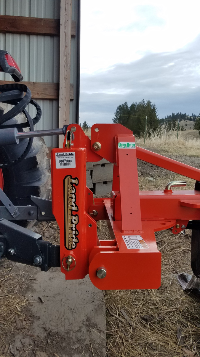

The Quick Hitch will move the cutter about 4" further rearward. I have the rear blade on the tractor at the moment as shown below. The 850 lb weight of the cutter is supposedly without the driveline, so if the driveline includes the gear box then this thing could easily be over 900 lb. I'll have to pay attention to the handling and will add weights if necessary.

You may get into a situation where you need to raise the mower off the ground (hitting a rock/stump/...) and need to steer. The weight of the mower will make the front light and steering difficult. You can use brake steering if your tractor has that feature. But I know I felt more secure when I got enough weight on front.
You can try it in controlled process and see how it feels and steers then decide what to do.
Thanks.
4" is a lot, and you will notice it. I am not a fan of quick hitches for this very reason.
No, the driveline does not include the gearbox but the advertised weight will not include optional chains which will probably add 150 Lbs.
I expect that you will need front weights.
