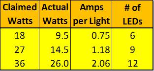

Before diving in to the deep end, perhaps you can try a pair of 27 or 36 watt lights with the current dynamo and judge if you need more light. You're investment will be approximately $25. I'd also forgo the use of the stock headlights all together, thus saving precious amps.
You might be shocked at how much light they produce. Don't believe or trust the claimed lumens or current draw. These are typically theoretical outputs of what the individual LEDS can put out. Most designs don't drive them to these limits. This might be due to the difficulty in transferring the heat immediately at the LED. It doesn't matter they are very bright!!!

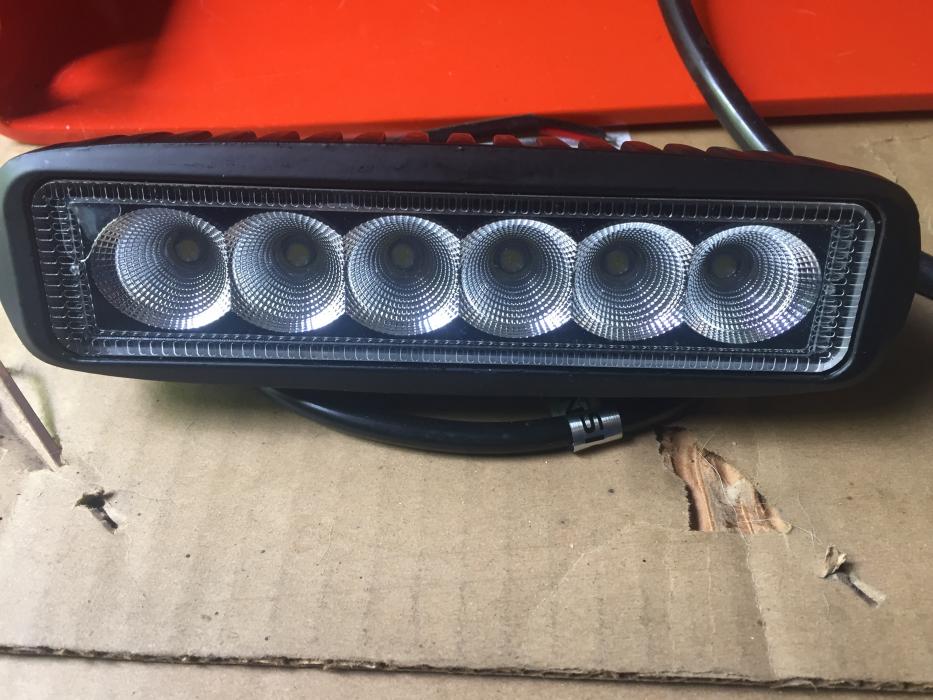

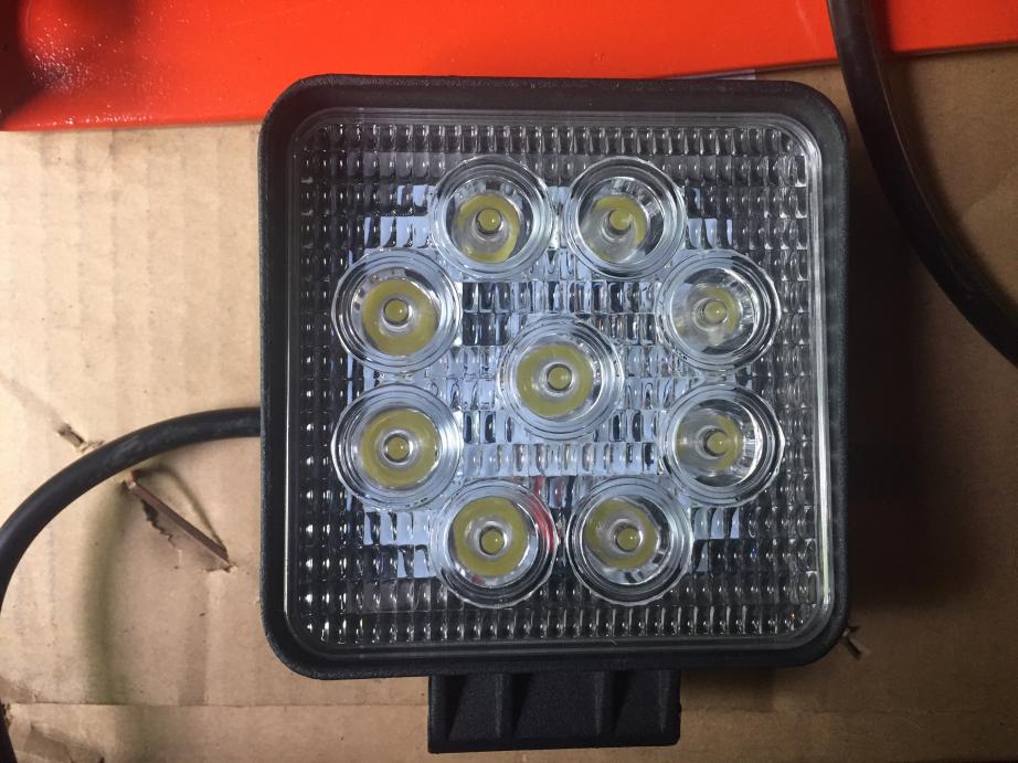

I've used about a dozen sets of the garden variety 18, 27 and 36 watt units typically purchased from Amazon for cheap. Measuring the actual current draw at 12.6 volts yielded: 18 watt lamp - 0.75 Amps, 27 watt lamp - 1.18 Amps and 36 watt lamp - 2.06 Amps This is for one lamp so for a set the values would need to be doubled.
Very happy with the light output of the 27 watt units. It is crazy how much more light they put out compared to the pathetic halogen headlights. My neighbor uses just one of these facing forward and the other rearward and is happy with the light output when plowing snow in the winter.
The 18 watt units work nice to illuminate the sides of the tractor.
Using the 36 watt units on cabbed tractors as they are nearly the same size as the stock Kubota lights.
Of course you can go the overkill route with the larger alternator and 42" light bars. They are very impressive, but I'm not certain it is necessary, however they look ultra cool.

Pictures form left to right: Summary of current draw. Example of 18 watt light, 27 watt and 36 watt.
