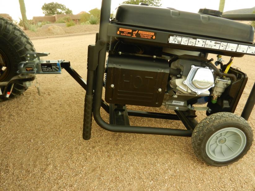

You might be able to weld that frame up, after straightening it, and make an implement for your 3pt. The possibilities are unlimited. The pins for your hitch are cheap and easy to get.
Having taken up welding, I hate to see metal go in the scrap heap. Right now, scrap is almost worthless but, if the trade wars stay alive for a year or more, that scrap will be harder to find because its so valuable.
Example: I found two pieces welded together in my local welding shop recycle bin. I cut them apart and then welded up a frame to haul my generator. GREAT generator but on pain in the shins to try and roll around. Its heavy and the handles are too short. So I welded up this frame and put a hitch mount on it...
The generator sits on the frame securely using gravity... It tows like its not there.
Anyway, you can figure out a good use for the wanky ROPS and make it a useful tool for the ranch.

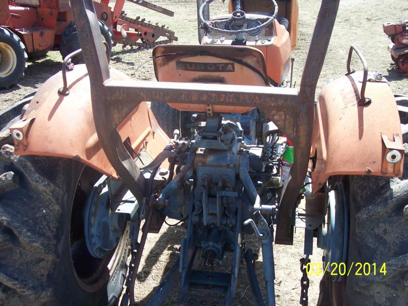

Every ROPS I've ever seen has been attached securely to the frame, usually around the axels using large U-Bolts. It's gotta support your machine in a roll over. Something looks wrong if you are bolting it into the rear diff case the way you are.
You look like you are missing a cross tube at the top and the ROPS should go around/over the rear fenders.
The way you have it shown in your photos its just going to fold up on top of you in a roll over. It looks more like an umbrella stand than ROPS.
Check out the ROPS on these guys machines to see what I'm talking about...
http://www.orangetractortalks.com/forums/showthread.php?t=6612&page=437
The ROPS are attached wide and around the axels, not narrow and bolted to your diff case.

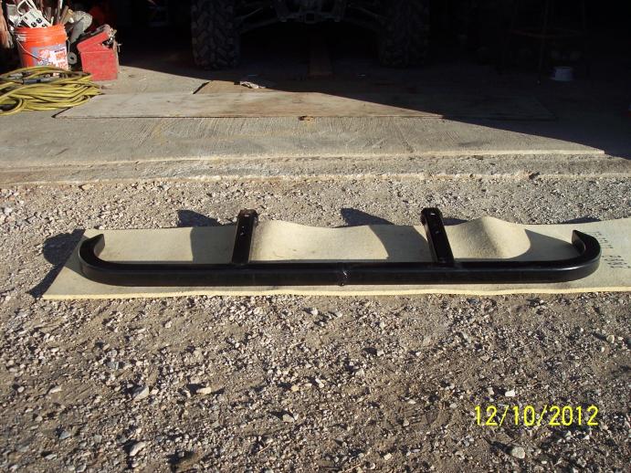

Here's an example of how to use a ROPS for other purposes. Was on a Grasshopper zero turn. Made a rear bumper for Polaris Ranger. All I did was figure where I wanted to use the angles, how much material I would need past each curve, cut and weld.
That design of ROPS (were it bolts to the back of the diff case) is perfectly fine and will hold up in a heavy roll over situation.
It's not required to attach to the axles to make it work safely.
Considering this is from Kubota I'm 99.99% sure it's been tested! ;)

Awesome "recycling" work Len! That turned out really nice... I might have to make one of those for my Ranger.
Welding is a blast. I have been a woodworker for 45 years and always wanted to stick metal together. Man, it's so handy. I wish I had started sooner.
It came from the Kubota dealership to fit on my machine. There is a riveted Tag on the Rops that has my machine model on it. Not sure how a Rops that fits my L345DT can get more legit than that.
And the issue here isnt if that Kubota Factory Rops kit is for my machine, I already know it is. The issue is that it was manufactured incorrectly.
