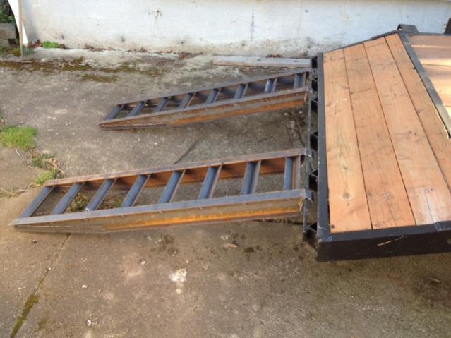

I just finished making new steel ramps for my trailer to replace the rotten 4x10s that came with it before the same thing happened to me... and I don't have a ROPS on my B7100.

The cost of having a welding shop build you some steel ramps like Bellinghamster built would be a lot cheaper than some expensive repairs to the tractor. I bet you didn't think about buying a lottery ticket when you got done.
