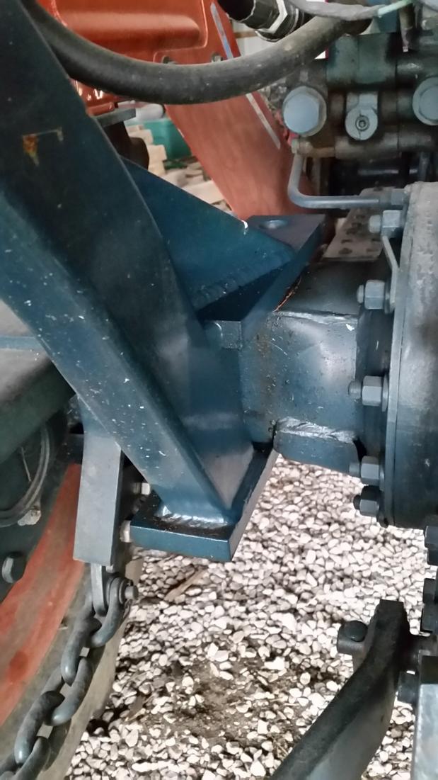

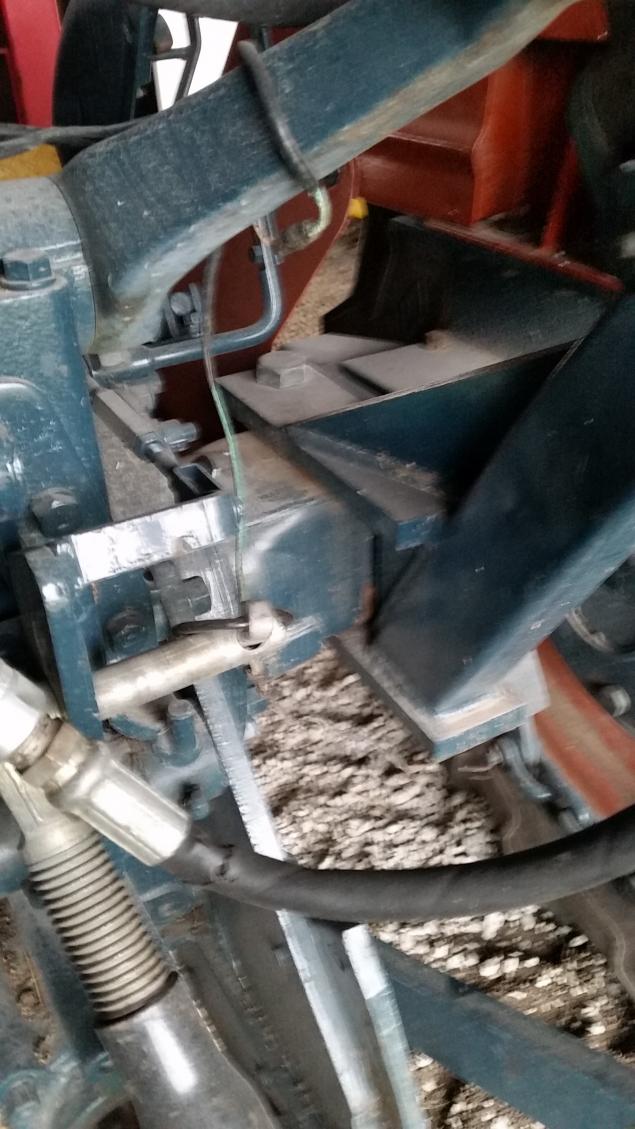

ABruce, did you find what you need for mounting? I've got an L305 and probably has same mounting setup. Let me know by PM if a picture is needed.
The RPOS comes down and sets on the axle just inside the fenders. It has a flat bar welded to to the base of the ROPS where it sets. Then there is a flat bar (like 1/2"thick x 2" wide x 7" long...just guessing) under the axle with two 7/8" (metric of course) bolts.

if you get a chance a few more would be great, I think I have it but it looks to me like the bar goes below the axle in the picture. A little more clarity would probably save me hours.

I'll make a note to get some. I need to go up where that tractor is anyways to snag a bale of hay!!
I do remember 2 ea bolts on each side.
14,240
6,415
Got some pictures for you. I was wrong! There are not two hole on each side, only one. Kinda dark in the barn.
The ROPS just slide over and under the axle and there is a bolt in front of the axle that holds it on and tight. The bolt is a big one, like 1" (in some metric dimension!!)
If you need clearer pictures PM your email and I can sent them directly to you. A couple taken at the same time, with the same camera did not upload because they were too big for the forum software.
