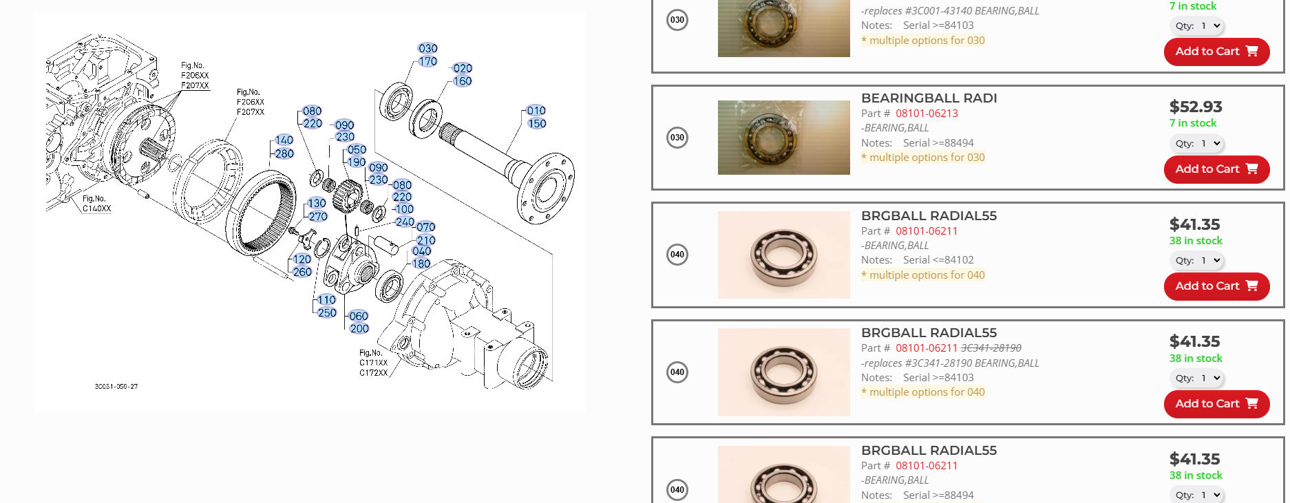

There is a lot going on in here bearing wise:
