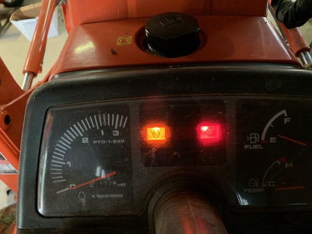

My battery was failing and was planning to get a new one. I needed to use the tractor (B7800) so decided to jump the battery; it was late and I was in a hurry and swapped the pos/neg cables.,,dang it!
I corrected it but damage was already done. I checked the fuses in the box, all good. The 30amp at the starter was blown so I changed it. I also replaced the battery. But, the tractor still does not crank.
When I turn the key, the glow plug and oil pressure lights come on (see pic), but the electrical light (middle one) does not. The blinkers and dashboard lights operate as well.
Any idea where to look next? thanks!

Double check that you don't have the PTO engaged or any other feature that will stop it from cranking.
Then I would start with ther WSM and the wiring scematic and figure out the most likely cause of what you could have burnt up.

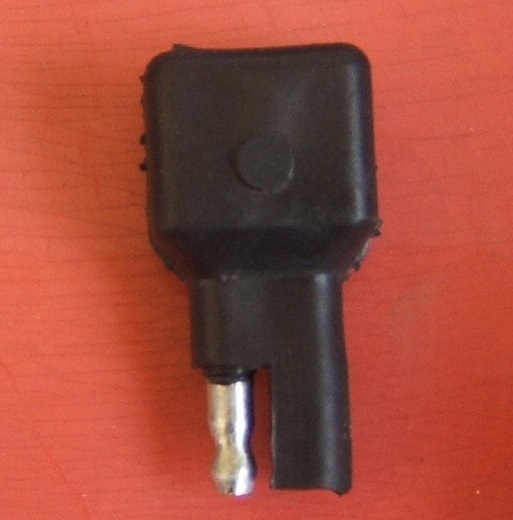

Your image is too small to read.
I have seen diodes used to prevent one circuit from back feeding another.
Like fusible links, diodes are likely to be a plug in style but not readily apparent.
Photos attached of another brand's diode style
Dave
Dave
Thanks, will start my search again...these are images are helpful. Hopefully my fresh eyes will find them...if not, back up to the service dept for help.
