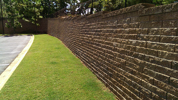

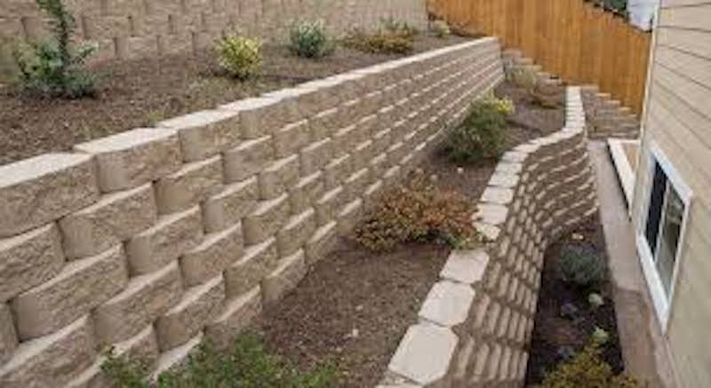

Lots of options, but, I'd stick with engineered wall block. Especially if it will be visible. These blocks are engineered to batter back into the slope by using mechanical means (pins or the block themselves will have a lip). You'll need lots of drainage stone and may want to use drain pipe and geo-textile fabric behind the wall as well.
I've found that most RR tie walls don't last (if they aren't installed correctly). They need to be anchored into the slope using dead-men (either timbers or chain/spike). The other issue with timber retaining walls as that they just don't drain well enough. You may be ok with only a 3 foot wall built from RR ties, but I'd still make sure they are anchored and backfilled with drainage stone.
Plenty of on-line and youtube instructional videos if you aren't familiar with installation. Most block manufactures will offer extensive installation guides as well. Not sure where you're doing this but permitting/ inspections may be required (I know, not what you want to hear).

I agree with dirtydeed. I don't have a lot of experience, mainly assisting others with building small walls or replacing a failed one of another type. These lipped blocks impress the hell out of me, especially the larger ones. Take care setting them (absolutely no debris between them and level) and it will take a quake to move them.

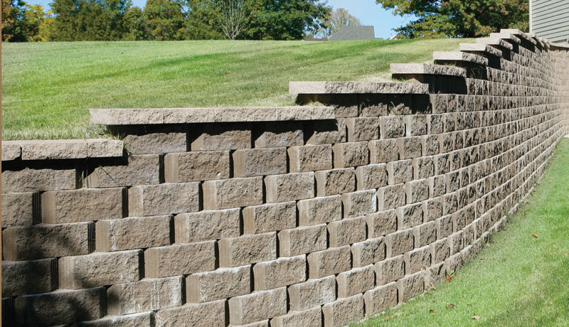

It's a matter of cost of material offsets:
1: Doing it again because you used cheap inferior material.
2: Lower skill level required to get excellent results.
3: Lower additional material requirements.
While simple cheap concrete block sounds good it will fail over time if not done the way required, IE foundation, rebar, concrete fill, pinned back into the slope, and proper drainage.
It also takes a good skill set to be able to set block properly, and it's not fast unless your very skilled.
Railroad ties or any landscape timber will also fail over time, they always do, and even quicker if not properly installed, IE rebar pinned to the ground, back into the slope, and to each other.
Most people do not have the proper tools (BIG DRILL) and long auger, and if you've never drilled a RR tie, they don't drill easy.
Most RR ties you can get now are junk, they are pulled off rail lines and are on there way out that's why the RR changed them out, and new RR ties are super expensive!
This solid block states 36" ( higher walls require hollow blocks and rebar and concrete fill) and at $605.58 a pallet it's not the work price out there.
there are smaller lighter versions of these too.

Yes, you'll find that lipped blocks do not allow for much height. They are intended to be used for fairly low walls (since they are "gravity walls"). They work better when glued. The better option is to use hollow core (either pinned, or geotextile reinforced). The hollow cores are obviously lighter to handle and are filled with drainage stone during installation as they add mass and also aid in drainage.
A poorly constructed wall/poor materials can fail easily following heavy rain events. I've seen them, and have redone many when I had my landscaping business. Trust me, you do not want to have to redo one. It's quite a bit of work and creates a real mess. :(
If you're considering these as an option, my suggestion would be to ask a knowledgeable landscape supply owner what they recommend for your area/soil type.
