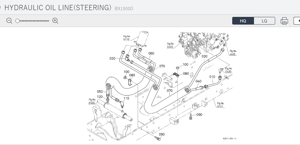

The WSM is going to be little help on this.
This is the line routing.
29,144
5,432
That picture is not the WSM that's a parts diagram.
I suggest you get the WSM and make the determination yourself if it's going to help you or not.
