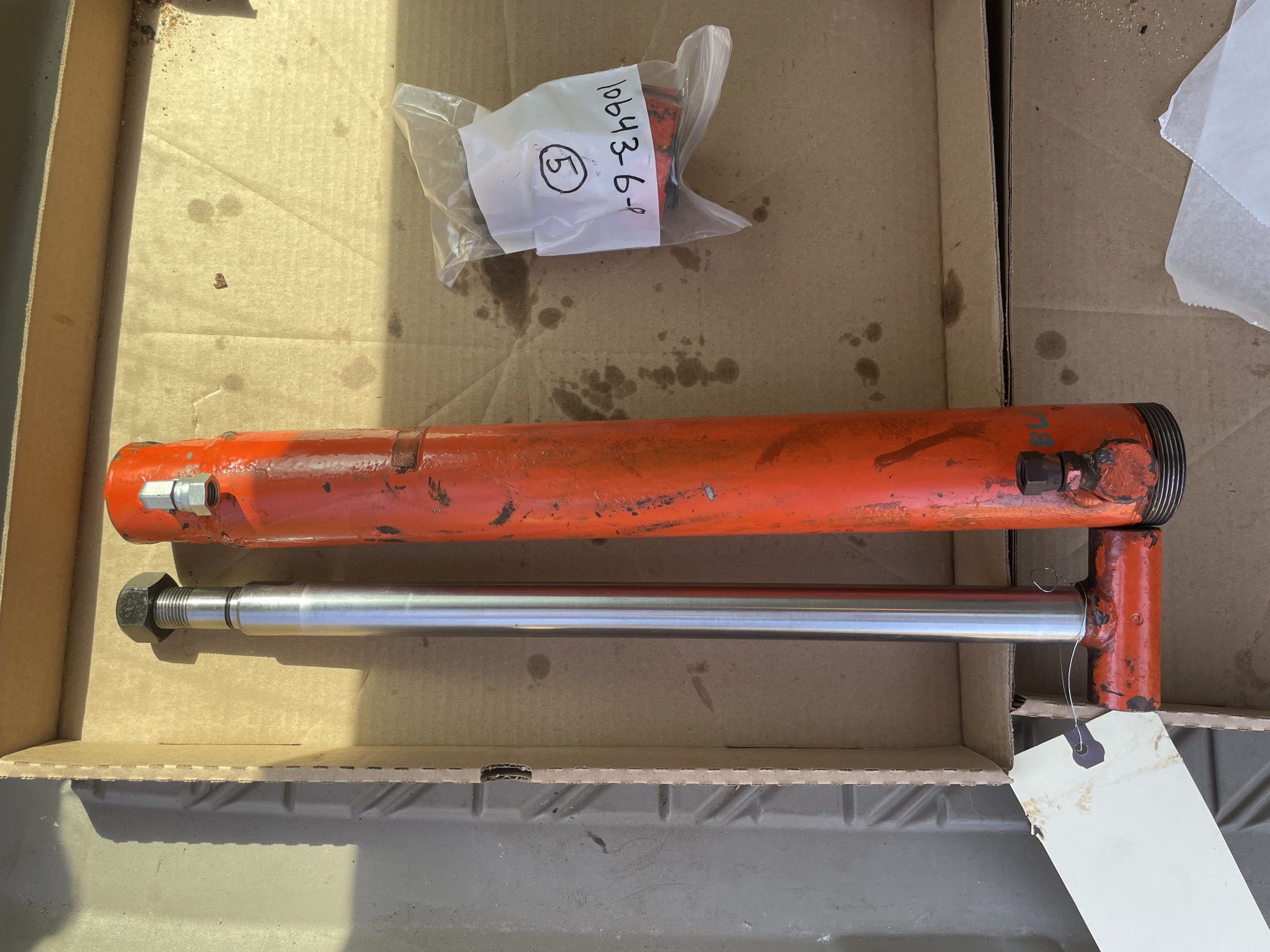

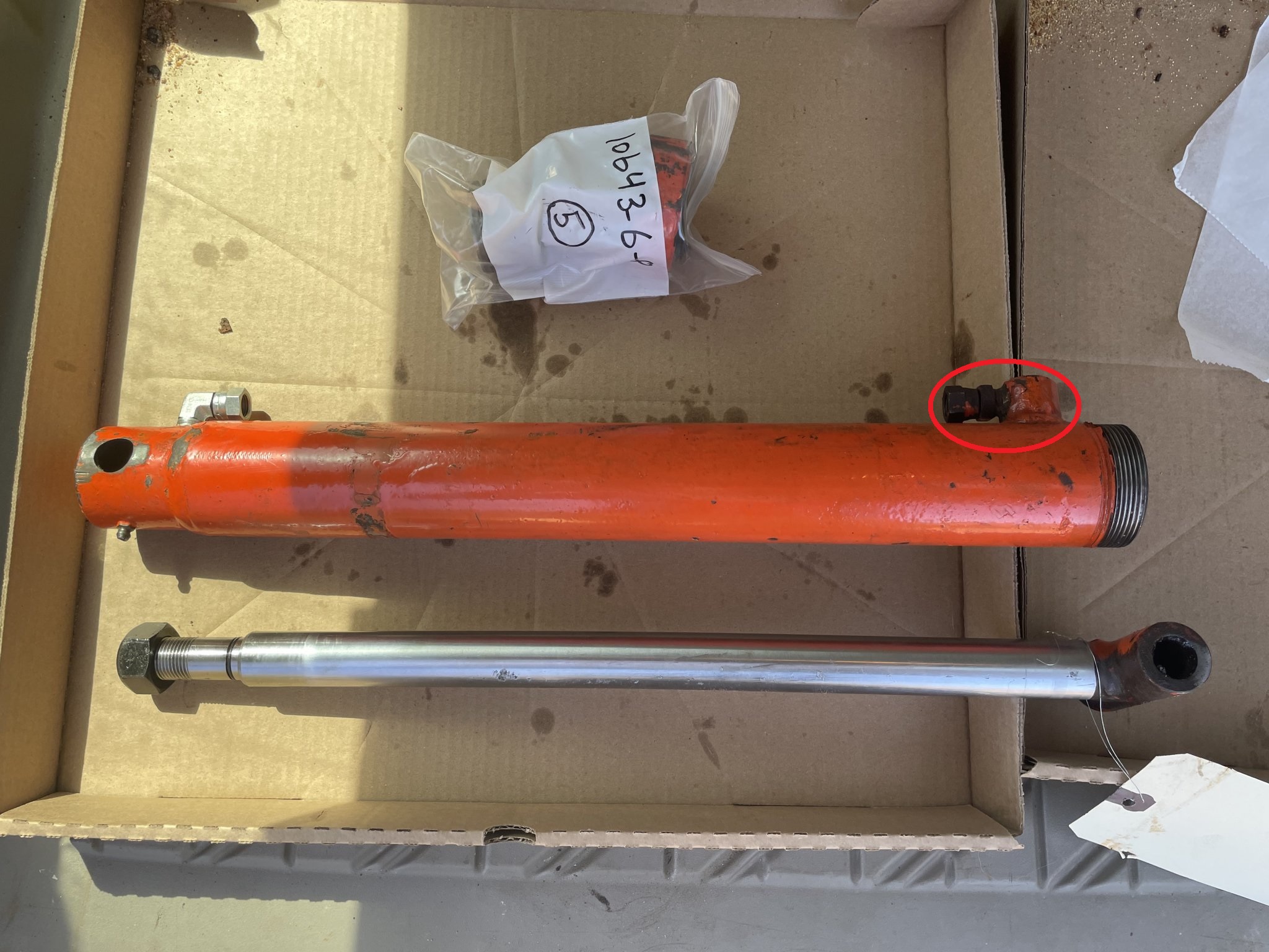

I think so, thanks! I just picked my old original cylinder up from the hydraulic shop. I’ll try and measure it up.
My pins are 3/4”. The holes in this one are 1”. I’ll need to track down some bushings. Looks like 1” to 3/4”…one at 2-1-2” long
Yes, very similar. The end connection is a little different, but that might not matter?
I just picked up the old one from the shop, see attached photos.
looks like I’d need two 1” to 3/4” bushings for that one. One at 2-1/2” and the other at 1-1/4”. Any suggestions on where to source those? Get one 4” long and cut it down to size?

You my want to get a second opinion on that rebuild . I've repacked plenty of rams for tractors & if it's just the piston I'd get another look at it .

Yeah, doesn't seem too bad to me, but I'm a novice on this kind of stuff. Between labor and parts I was thinking the cost would be close to what a new replacement would cost. The new one posted by GreensvilleJay is $229.
Any idea what a typical cost for repacked cylinder would be? I'm in MA.

Using a tape measure, I come up with 21-1/8 for the retracted length. Basically lifted the stabilizer leg all the way up and measured from center of pin to center of pin. Thinking it's probably 22".
Cross tube fit is good. The leg connection is 4-3/16" wide, so it has bushings on either side of the ends.
The port on the original cylinder is SAE 4. The Chief is SAE 6 and the Magister is SAE 8. Any issues using a reducers?
