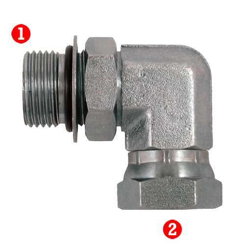

Dan - Existing are 1/4”. But the new cylinder is SAE 8.
I am talking about the hoses not ports. What size hoses do you have now? You can also use a short (6") length of 1/2" tube and 90 degree male ORB x male JIC port adapter that would give you pretty close to original clearance.
