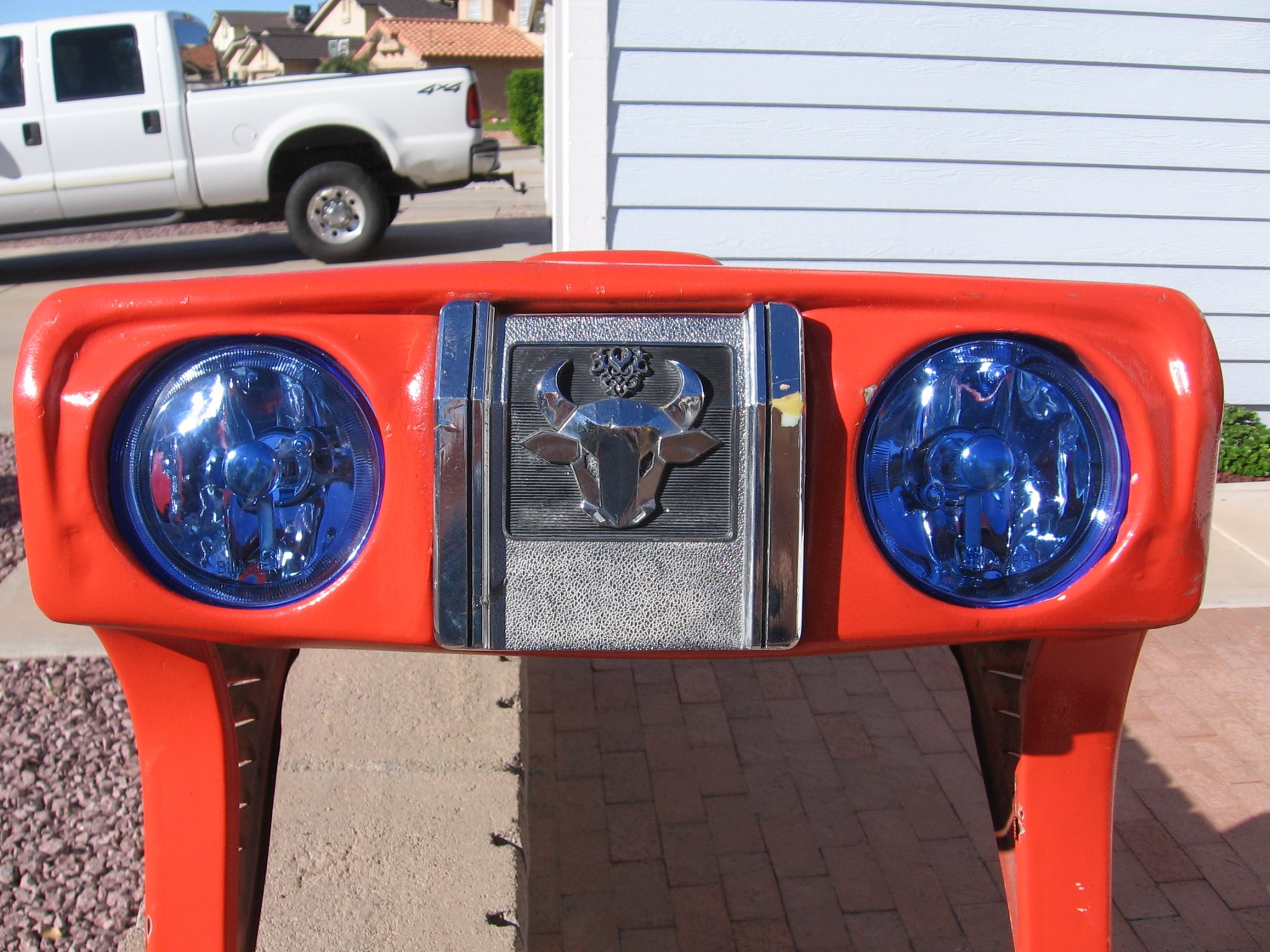

This is what I did for my B7100, right before LEDs became common.
I found these on a clearance table at O'Rielly's (or Checker) a few years ago. They were cheap, and very bright. I glued a large o-ring (or maybe vacuum cleaner belt) to the front and made these new hold downs out of 1/8" aluminum. I know that is not much help, but maybe you can get some ideas from this.
