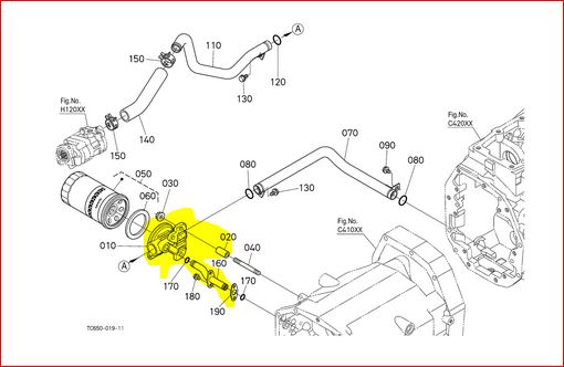

Yes you can get that part, but there are other O-Rings that should be replaced when you do it.
Go here, say yes to the legal at the bottom of the page, and then pick tractor, go to, Hydraulic System, then Hydraulic oil line (input).
http://www.kubota.com/part/partsList.aspx

As pointed out it looks like a pretty easy repair. I would go for the base, o-rings and maybe the #160 tube if it's not to pricey! And at this point MAW go for the 50 hr service and grab both the HST and hydraulic filter.

I have gone on the website and sent a parts order list to my dealer. I will hopefully get them in time to make the repair this weekend. I did order the tube, "O" rings and gasket as well just to be safe, along with a new filter (pricey).

I have replaced that part before. It's not too bad. There is a metal pipe that goes into the transmission that also usually gets damaged so be sure to check/replace it while you're down there.
