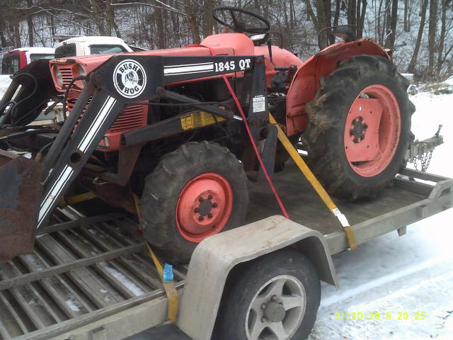

Before I post I just want to say thanks to all of you who have replied with helpful advice.
The tractor is outside in the cold with the loader still mounted. Plan is to start splitting tractor January 1st because other project is occupying garage space and that project needs to be finished first.
So while still outside I decided to do more initial assessment and found some disturbing issues. :(:(:(
Pulled the crankcase oil dipstick and was full to the top of the dipstick !!!!
So assumed water may have entered crankcase.
So I removed the plug and out came 2 1/2 quarts of green water...
So I put plug back in when oil started running out.
Then skimmed oil off the top and tested antifreeze and found to be good to -16 degrees Fahrenheit ... which is risky in my part of the world.... but have not seen -20 in quite a few years. -32 is all time record low here.
Head was off when I bought the tractor and so I looked down into water jacket surrounding cylinders and saw water. Measured water and was 2 3/4 inch deep and maybe 1 1/4 inches from top of the block.
Loader is keeping me from dropping the pan or I would drop it to see if crank and cam shaft are rusty.

Well then give that's almost 10 years ago, it's done right. :p
Older Kubotas are know for head issues, I've yet to see a block that cracked from over heat or freezing, I have seen a couple with holes punched in them from flying rods.
I've seen quite a few filled with water and they didn't do any damage at all to any of the oiled parts like the crank and bearing surfaces, most of the time it doesn't even phase the outsides as they were oil soaked before the water got to it.
