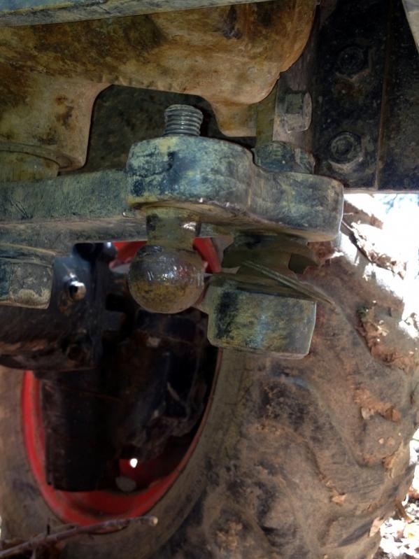

I have a 2005 L3400HST. I just bought it last week.
See the steering linkage part diagram at https://drive.google.com/file/d/0B7Vvx74a-airRFpMdHhaQjZxSk0/edit?usp=sharing
The right tierod inboard tierod end (the end closer to the pittman arm) broke. The ball and socket separated. I can't get the pin (threaded on one end and with a round metal ball on the other end) out of the pittman arm. I removed the nut but need to know if I should just pull really hard, or if the pin itself is threaded?
On page 2 you see the diagram I'm talking about. Part 140 is the right tierod pin assembly and it is what broke. I removed the nut (#150) but can't pull the pin out (down) of the pittman arm.
Any suggestions?
Thank you
Chris

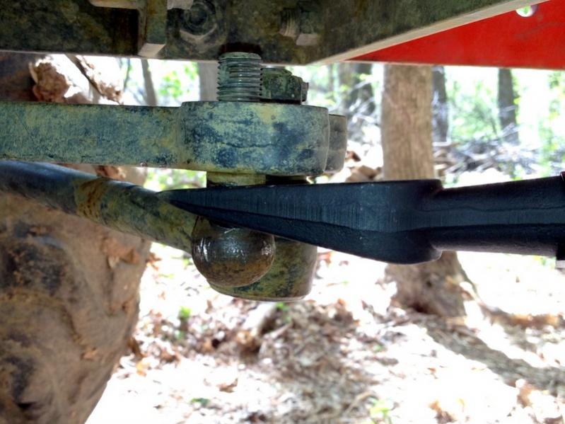

Got the pickling fork and hit it with a 5lb hammer, pretty hard, but the tierod end pin didn't budge. The pitman arm is still on the tractor and I don't want to break anything else. Should I really whack at it until the tierod end pin comes loose?
(The second picture may give the impression that the pickling fork wasn't fully forward and seated - but - it was - just not when I shot that picture).

In the second picture, will the fork touch the ball and the pitman arm?
In the picture it has a gap, if it does it's not going to work right, it has to wedge between the pitman arm and the ball.
You could use a pitman Arm puller or a very large gear puller.
Sorry I would have said pitman arm puller in the beginning if I had seen a picture first of what you had going on.
33,391
8,704
If that's the case up the hammer size and whack it hard! ;)
