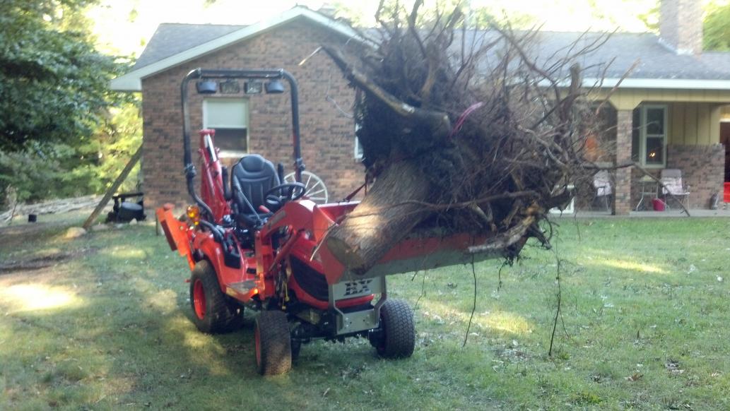

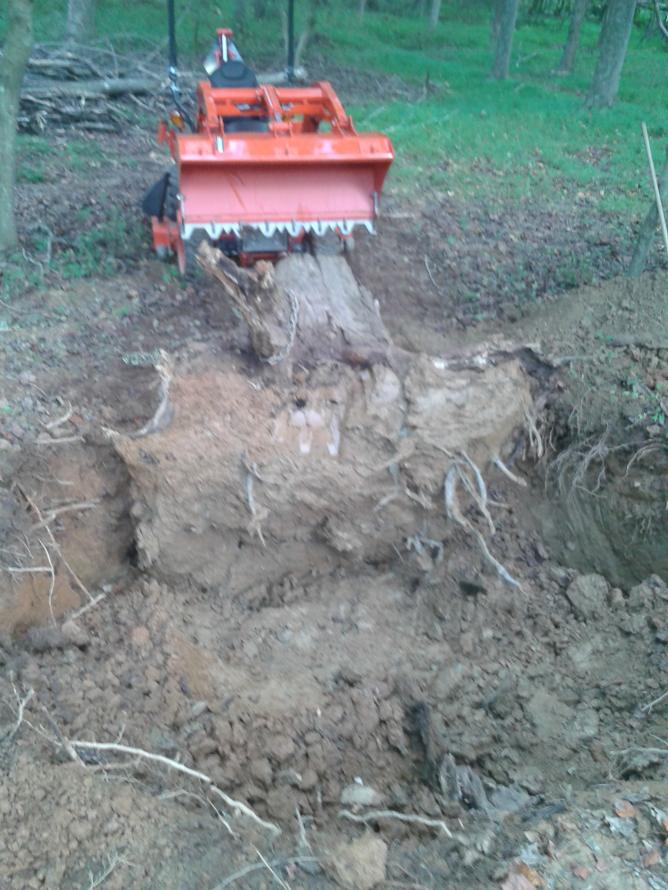

AS others have said, WHAT kind of stump is it, and how much time to you have?
I first got my BX and started right on the stump, the stump laughed at me.....
for a while, then I went off and did other things.....came back to the stump.
It was an old sycamore stump, it had about 4 or 5 large roots shooting out @ 90 degrees. Having got better on the BH , it was about a 4 hours job, lots of moving around, which means you on on and off the machine moving. After a while it became a task that I had to COMPLETE! AND I did!
