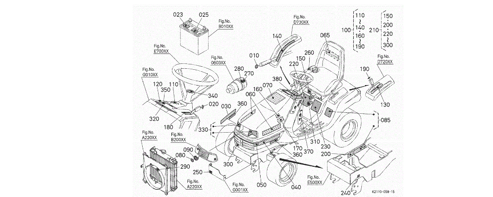

Has anyone ever had any luck removing and reusing the KUBOTA emblems (or as the parts book calls them "labels") on the sides of the fiberglass hood? It would be item number 60 on the drawing
