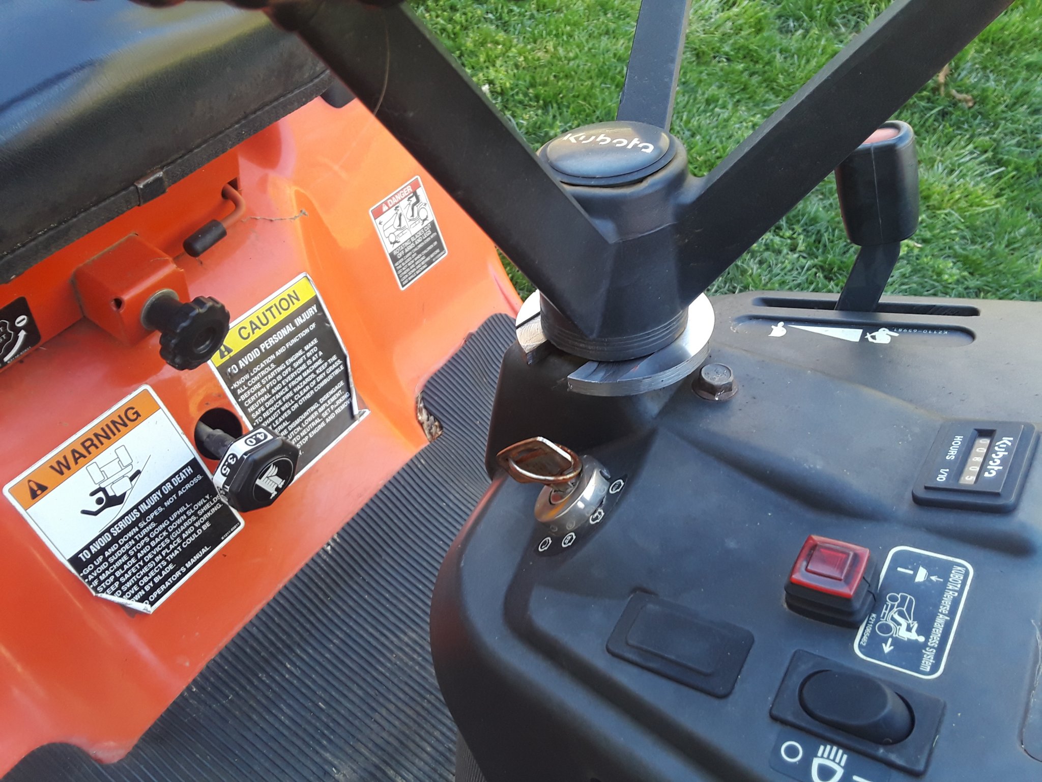

So I would really like to get the steering wheel off. So far everything I have tried = failure. I even asked the dealer service dept if they had a puller I could perhaps buy or borrow. Service tech said they just put a pry bar under the wheel and "zap" it on the top shaft with his Snap On air hammer. I even tried that. No Bueano. I really want to add in some accessory wiring and do a new fuse panel but I really want to remove the center stack to do this.

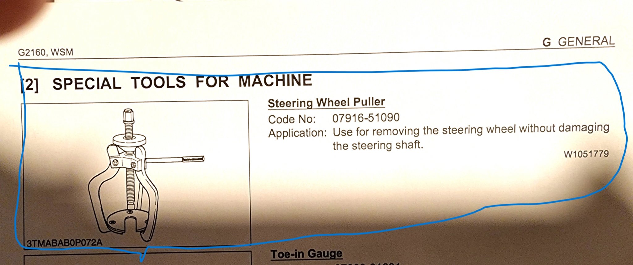

Yep, I bought a bearing separator set from Hazard Fraught yesterday. I may also try to get a larger fender washer from Fastenal today so there some "purchase" for my 3 jaw puller. I tried making a pulling shim with a 2.5" one but nothing is outside of the diameter of the hub enough to get under it. If I knew how to weld I would make a puller with one of those large fender washers and sacrifice a 2 or 3 jaw puller by welding the arms to it. Here is the actual Kubota one. Messicks sells it for $986! Ouch!

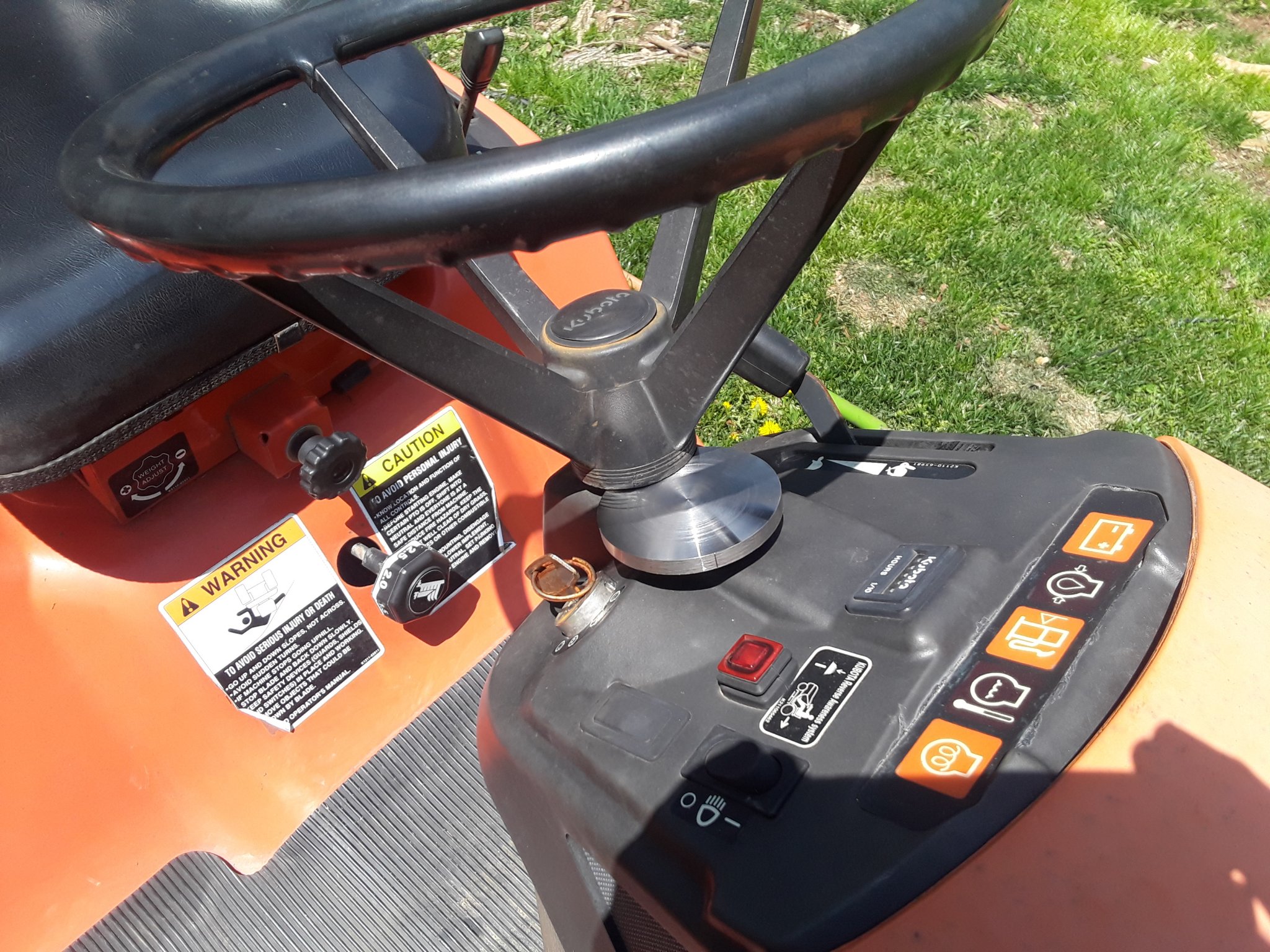

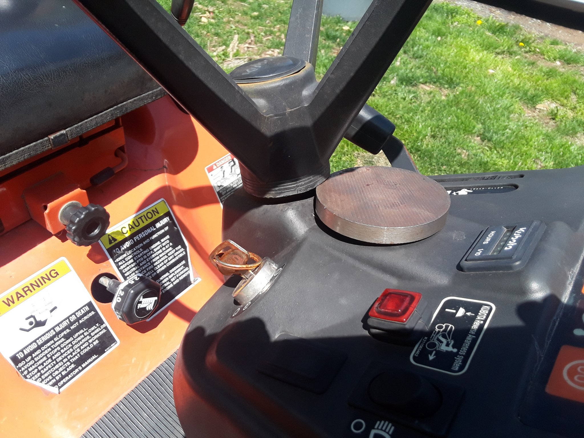

I tried the HF bearing splitter - not a very good fit. This piece of scrap is just a little too thick but i can fix that and turn it into one of those OEM adapters with half an hours work.. Lot less than $900.

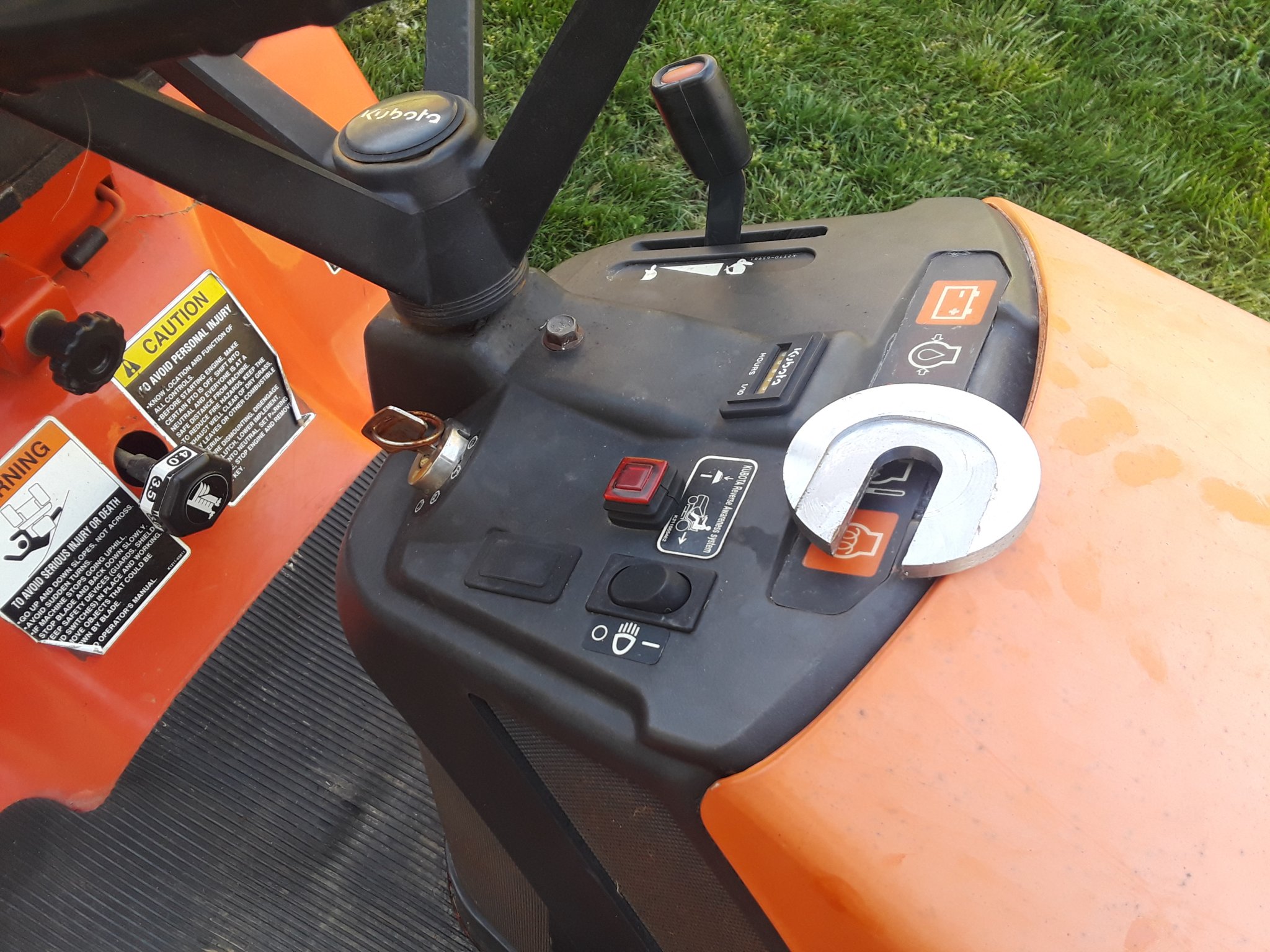

Thst did not take long - all it needs is the slot
Slot is done - fits nicely but could be another 1/2" bigger in diameter so the puller arms have a bit more clearance on the hub
