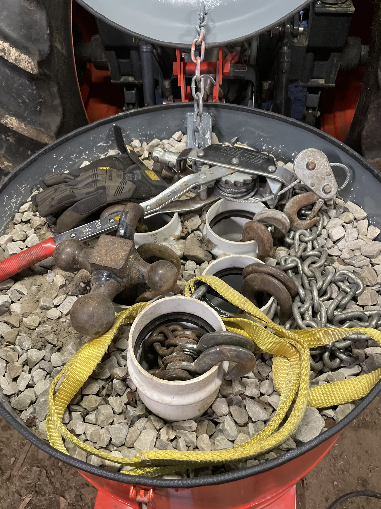

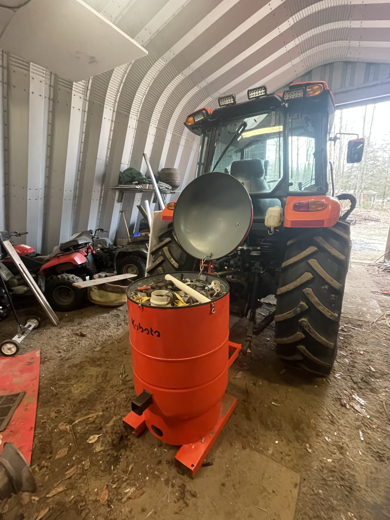

je1279
LX2610 w/ 60" MMM, LP 72" Snow Plow, EA Wicked 55" Grapple, and Woods 60" BB
Dec 6, 2020
828
581
Upstate NY
I agree with @Kennyd4110. When plowing snow, using my ballast box, instead of my box blade, makes working around buildings, vehicles, and other objects much easier. Yes it's a one trick pony, but nothing beats it for rear ballast when working in close quarters.
