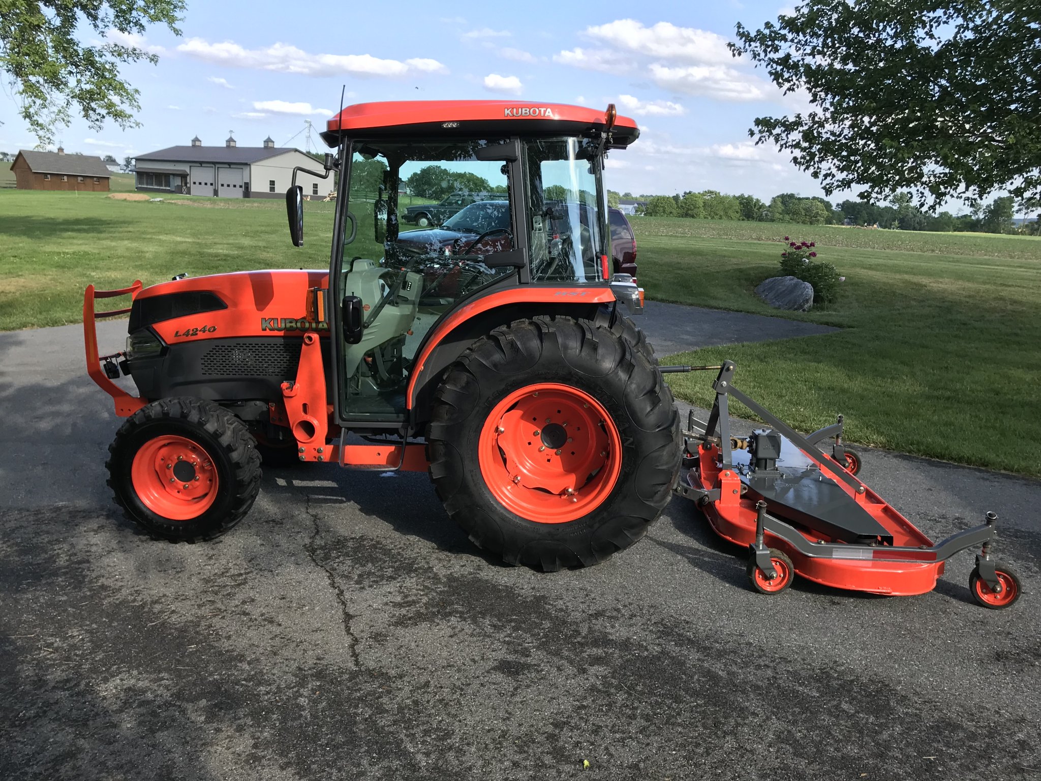

A response I made a few years ago on another forum. Parts have been easy to come by. AgriSupply has them and some parts are generic. I've found bearings at a good hardware store about 1/2 hour from home. The 5' Caroni (now reassembled with parts from two donors) still works great:
The 5' Caroni we bought new around 1991 is just about to be retired. That deck resides on the Ford and is a backup (and has been abused badly). I've had a 5' LandPride AT on a B7500 and a 6' LandPride 1672 on the L3200. LandPride makes nice equipment and they worked fine.
Last Summer I bought a Caroni 91" RFM that needed some love, knowing we were going to replace the L3200 with something that would have a cab and a few more horses. It took a couple bearings and misc things. For convenience I added the extensions for the spindle grease zerks. The 6' LandPride was used on the L4240 several times until the 91" Caroni was ready. It worked OK on that tractor.
The 91" Caroni is right at home on the L4240 and it works great. I did leave the deflector off the back because it distributes the clippings better without it. This is the best mowing combo I've used since building here in 1989. The Caroni decks are lighter and not as beefy as the LandPride decks. Still love them. A week ago there was a used 5' Caroni on Craigslist and I snapped it up. It will replace the original one on the Ford and since most of the Caroni parts swap I'll have spare parts on hand. Here's a shot of the re-done 91" Caroni.

That does not resemble that home made cab that served you well years ago. In time, many thing change & a/C becomes a feature of importance. Nice rig.
My WONDERFUL Brother-in law suggested to his sister that chim was getting older and a cabbed tractor with A/C would help him cope with the heat and pollen. Had the L4240 since December of 2018. Hung onto the L3200 till Wifey pestered me to sell it a year later, so I listed it for sale here and on CL. Sold quickly :)
