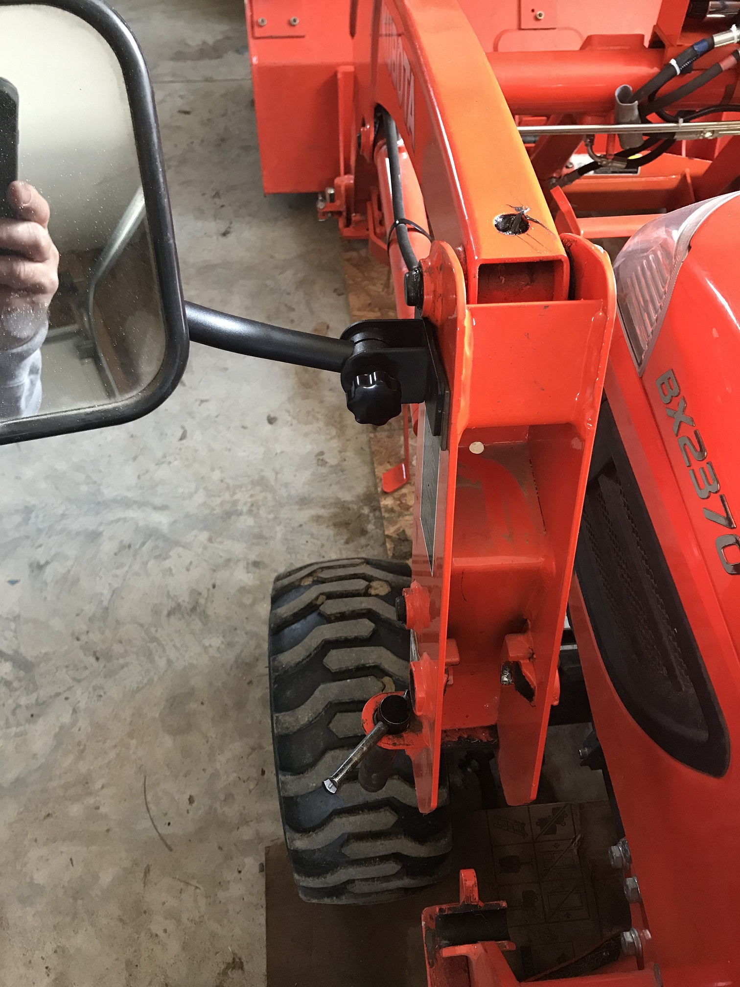

Thanks to @Ping and @D2Cat for the idea. With some Jeep mirrors and coin neodymium magnets from Amazon, I finally have a rear view mirror that will hopefully save my back a bit.
Ping
BX2370-1
Dec 25, 2018
335
300
Troy, Ohio
Glad we could help! Don't forget to pay the bill we'll be sending your way. o_O
Hoping they work out well for you.

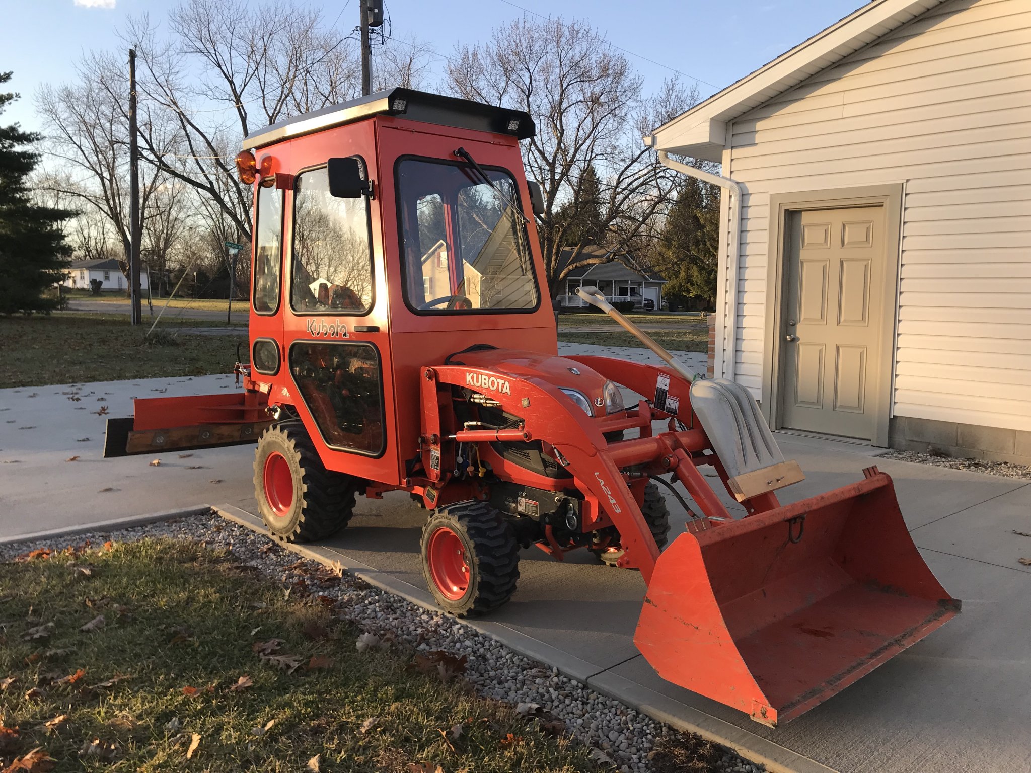

I'm planning on adding some mirrors to the recently installed cab. I've tried them before, but found small mirrors, AKA golf cart mirrors, to be of minimal use. I use them mainly when backing up after that first swipe in the snow, so like to see the rear tire to keep it right in the tire track. This puts the mirror so low, I can't see where I'm actually going. I tried mounting the mirror real low, but now it's so low it's not a "natural" sight of vision.
I see some have mounted multiple mirrors, so apparently I'm not the only one with this gripe.
I've always hated spotter mirrors. Give me a flat mirror that gives me a true representation or give me nothing.
My plan now is California truck mirrors and make up some kind of mounting bracket. Time will tell.
