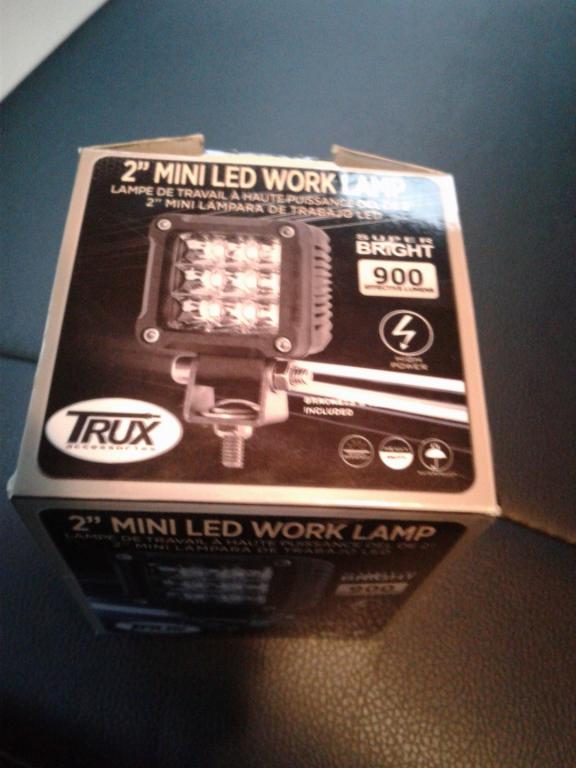

Do you have a Freightliner/Western Star truck dealer around you? They carry these TRUX brand LED lights.
I just got these tiny 2 inch cube lights for backup lights on my dump truck due to space limitations I have at the rear with all the other equipment.
They are incredible. These two little cube lights throw enough light that when my 24 inch 120W light bar ever fails on my B2620.....I'm just going to use these next time. They throw enough width and distance that they are all you ever need on a tractor. And small enough to mount anywhere.
And they only draw .87 amps. And they were only 20 dollars each in worthless Canadian money! LOL.
Thanks for the suggestion. I saw they had a website in your pictures on one ofthe packages and found this link showing all their light options:
https://truxaccessories.com/led-work-lamps
EDIT: They sell their products on Amazon as well... https://www.amazon.com/stores/node/...Trux Accessories&ref_=bl_dp_s_web_19548463011
