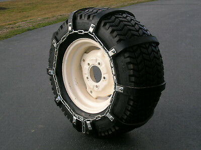

Does anyone use rear chains on a BX without spacers? I cant use spacers because of my 54" mid mount mower deck and im not going to install and remove spacers every winter. I know theres not much room for chains on the BX. Are there any other options im not aware of? I was thinking maybe some type of strap on grips where the strap just runs through the slots on the wheels. If anyone uses these or has a link to some good ones let me know.

I have chains on the rear of my BX2380. THey've never been off. No spacers. Turfs,
I snowblow, mow, whatever.
They tear up my gravel driveway a little if I am doing tight turns (it's in 4WD 90% of the time) but
other than that, they've never moved, nor do I notice them in any way. I just leave them on.
I got them as I am a high snow area with lots of freeze/thaw cycles (ice) even though my dealer told me with a big blower and turfs and pretty flat land he'd doubt I'd ever get stuck. The chains are my insurance policy of that statement. I don't own a 4WD truck or other tractor that I would be able to yank myself out if I *DID* get stuck, so the $200 (or whatever I paid) was $$ well spent in my case.
I don't recall the exact model of chain, but I bought them here in Canada from a place in BC. They are just "normal" regular link chains...nothing super fancy or with big gawdy lugs, patterns or anything.
I got them from "canadianchains.ca"
I could pick the size online, and have them delivered in a timely fashion. Lotsa good reviews of these guys.
<<<>something like these
8,426
4,083
Yep, I've been putting chains on my BX2360 for years. No spacers with R4 tires.
Simple ladder chains just like ve9aa.
I just keep them tight with tarp straps.

Use chains on my BX 2370-1 for the last 7 winters. The chains I use are old Semi truck chains that I made fit onto my BX. I do use a 1/2" wide wheel spacer. Being that there only 1/2" wide I'm still able to use the oem studs and bolts ,there is just enough threads to do this . Using them gives me a bit of piece of mind. The spacers are actually weld on drive hubs , that I bought at Princess Auto I did have to drill the holes through the plates to match my wheel stud spacing.

I've used these "Softclaw rubber tire chains" on my 25hp snow clearing machine clearing snow from asphalt and they work great, are durable, made in USA and not too expensive.
These are what I run on my BX25d. I leave the BH on all winter so there’s plenty of traction. I even go off road and blow trails through my mowed areas…great for walking the dog all winter long as we can have a few feet of snow on the ground most winters. Love my BX and BX5455HD combo!

View attachment 87516 <<<>something like these
