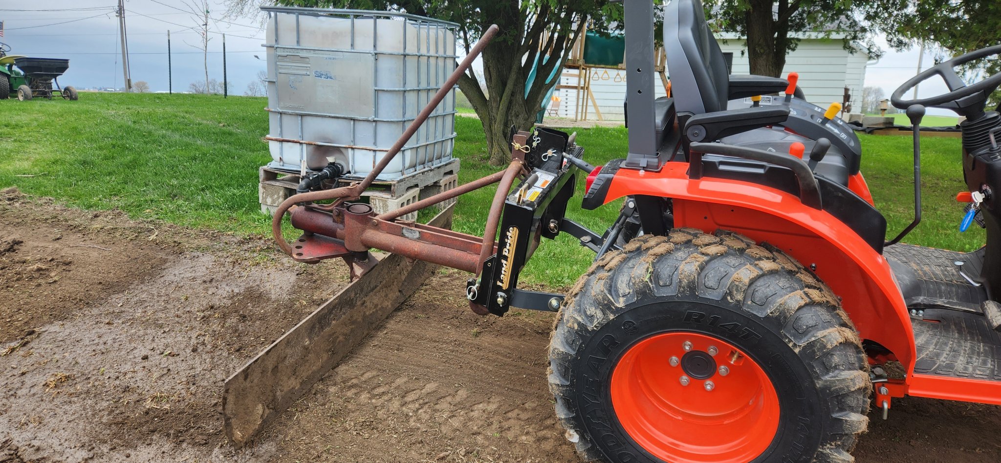

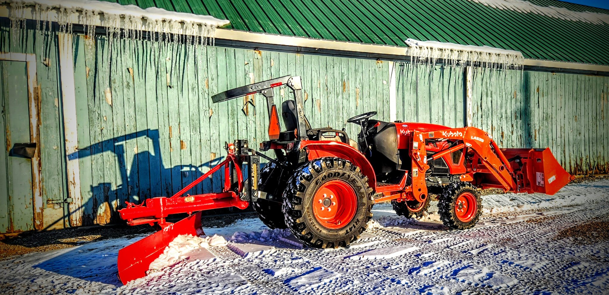

Nothing wrong putting a 6 foot back blade on your 2380. I have a 6 foot back blade on my 1880 with no issues. But I turn the blade backwards so is curves to the back. Then I adjust the top 3 point to my liking. Works great moving snow. I have my loader on so if I need more front traction, just put snow in the bucket.

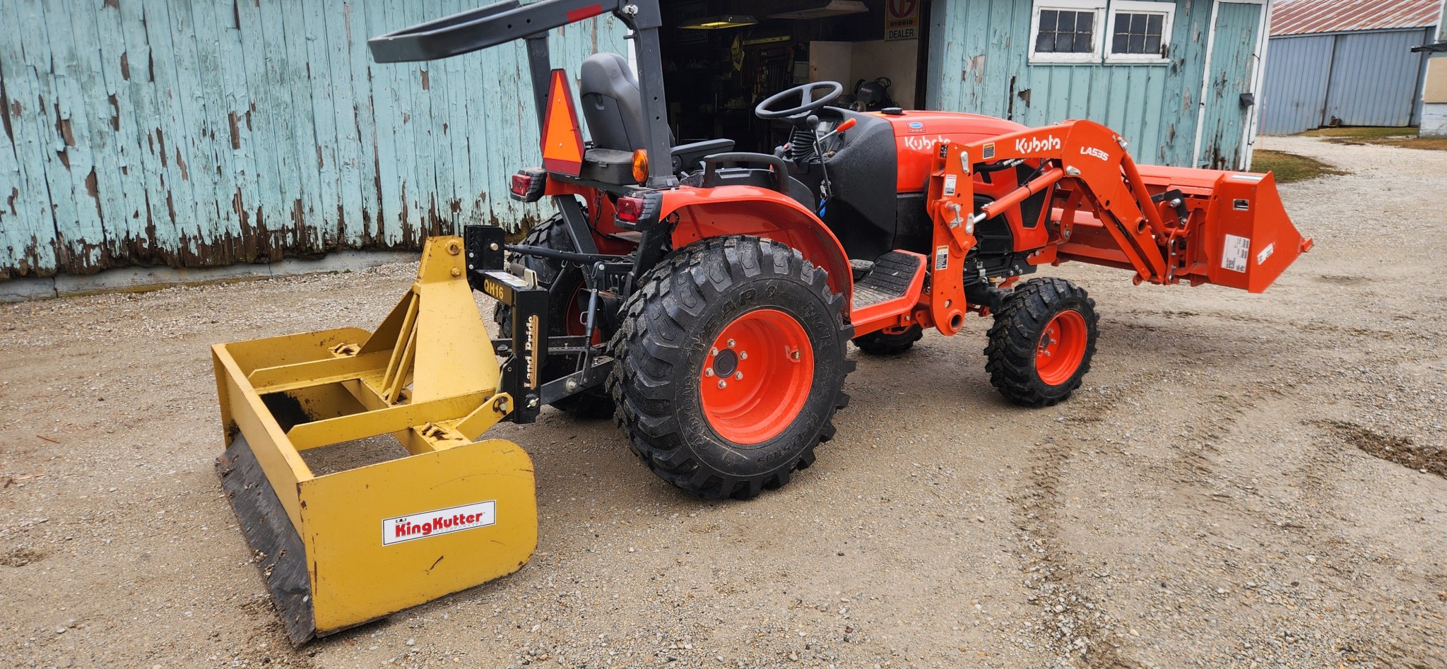

I'm not a fan of flipping the blade either. The snow doesn't roll off from it, or you can't toss the snow going fast, but it works for other people. My box blade leaves a nice smooth surface with the 2nd blade and very little gravel pick up, but a box blade doesn't work for everyone either.

I always turn my blade 180 degrees when moving snow from my gravel road and it definitely moves the snow without digging into snd moving gravel. But it’s 8’ and 1000 pounds. I also use it backwards to smooth and grade the gravel during the summer. The only times that I use it in the forward position is when I’m cutting ditches or pulling gravel out of ditches. Also when cutting and moving dirt.
