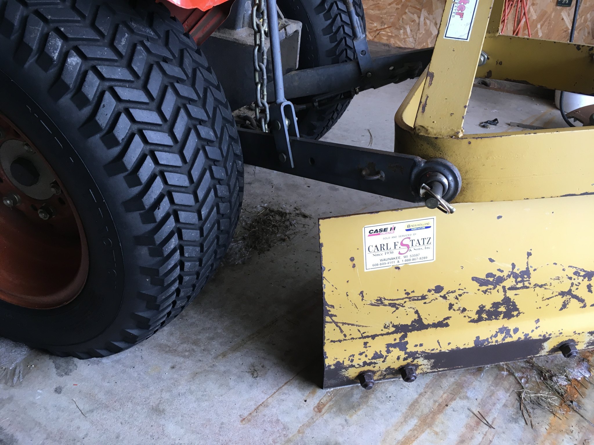

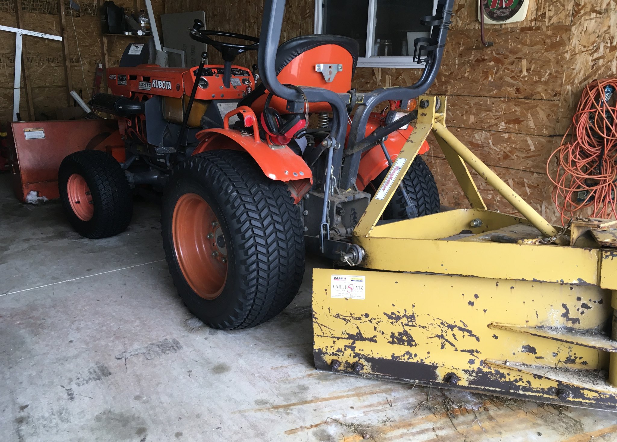

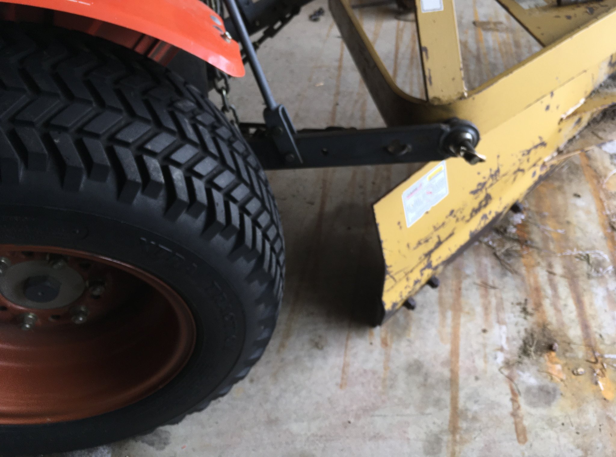

Follow up to my post stating I can swivel my 6 foot King Kutter blade 360 degrees.
I would guess that the 3 point geometry in relation to the back of the B7100 and relative small sized diameter rear tires allows me to do this. For me , on this tractor the length of the top link is more critical than the length of the blade hitting the tires due to the bottom tip of the blade coming close to the ground and the top tip hitting the lower link arms.
