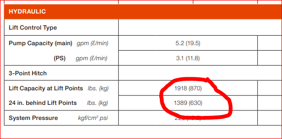

Your machine will pick it up I would bet according to this :
It might be a monster to use however! As Mike said - really depends on what you plan on doing with it?
