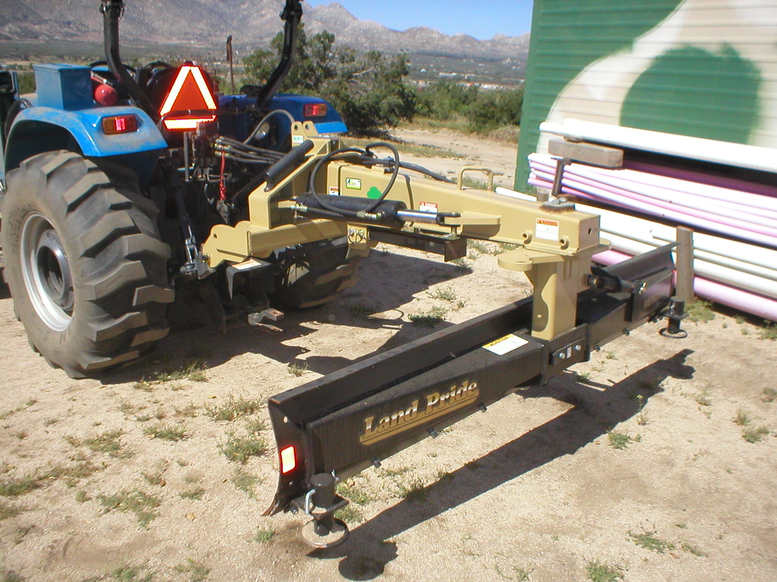

For comparison, my 8’ Bison blade weighs 1025 pounds, but it is a category 2 implement.
