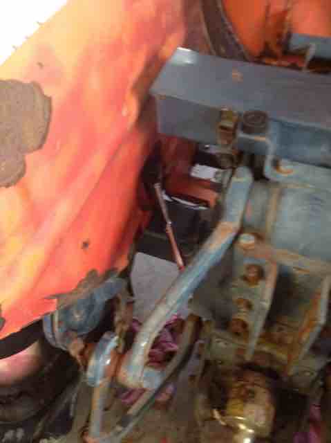

I first soaked the fender bolts with a 50/50 mix of acetone and ATF fluid. A medicine bulb worked good for getting the mixture into the tight spot for the bolts. ;)
After applying morning and night for 4 days, I decided to get started. Getting to the bolts was tight. And the bolts did not want to give up very easily. After soaking, I still had work the nuts on and off to work all the crud out of the threads. The first bolt where I had more room took 20 minutes.
The second nut took 1 hour!!! :mad: By the time it came loose I had invented new cuss words, and was cursing the bloody engineer who came up with the mounting design for the fender :rolleyes:
It worked out to 3 clicks forward, two clicks backwards on the ratchet.

Finally got the last nut removed, and the fender off :)
Gonna chase the threads with my tap and die set before installing the fender back on. Gonna fight and pull the fender on the other side as well. They need to be straightened and the paints flacking off.

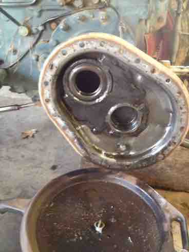

Figures, got the bota torn down. Now they are calling for snow Sunday :eek:
Got the gasket and lip seal today :)
Removing the housing and draining the oil was easy breezy compared to removing the fender :rolleyes:
Gonna take the lip seal and housing into work to finish tearing it down. The housing needs a serious cleaning on the outside. Plus I have a better selection of tools and pullers there :D
Gonna inspect the bearings while it's apart. If they seem to be worn I'll run over to the local bearing supplier and have them match them up.

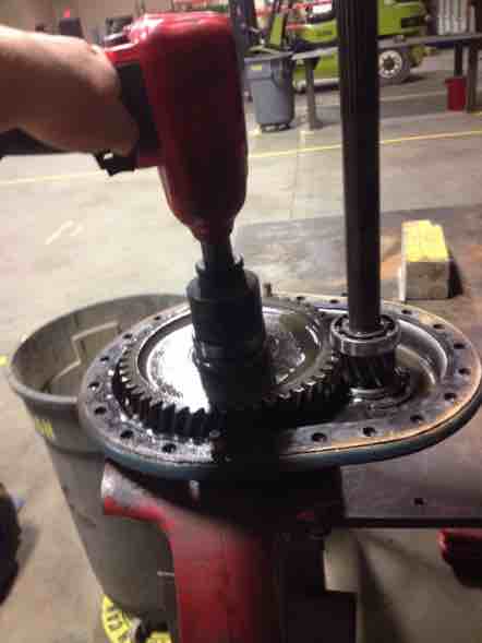

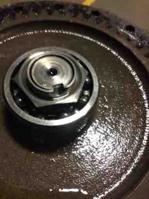

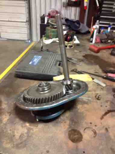

Went into work early this morning to dig into the case :)
First thing is to remove the nut. It has a flat spot in the shaft. So first thing is to pry out the dimple so the nut will move freely.
Then hit it with an impact after setting locking into the vise. Socket size is 1 13/16" or metric equivalent. Didn't have either, but an 1 7/8" socket works in a pinch since it's only torqued to 140 ft/lbs.
Next, loosen the vice so it just supports the case. Then a dead blow makes quick work of removing the shaft from the bearings :D. Make sure and keep track of the order on your spacers and brass rings.

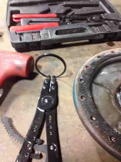

Next I removed the snap ring holding the bearing in the case.
Then the wiper sleeve off the shaft that the lip seal rides on. A couple of alignment bars make really quick work of it ;)

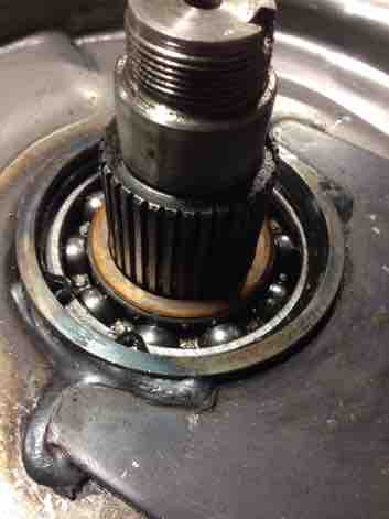

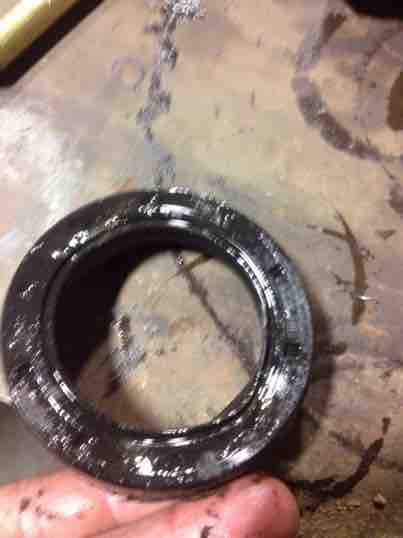

Then removed the lip seal from the case.
NOTE: there is a second snap ring in between the bearing and lip seal. When removing the lip seal, take care to not damage the snap ring
After removing the lip seal, it dawned on me why it had been oozing since I've owned it. Someone had replaced that seal before and installed it spring side out towards the tire :rolleyes:
I read through the service manual the other day, and it was very specific and stated "Spring side of lip seal, faces towards the bearing!!"
Nice thing is the lip seal comes with a new sleeve as well :D

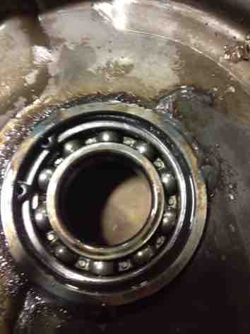

Bearings look great. With no signs of abnormal wear, tear, or scoring. So they are gonna be reused :)

Here's a good closeup of what happens when the seal is in backwards. Spring facing the tire.

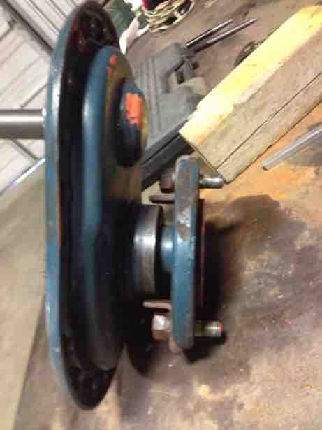

Ran the case through the parts washer for a while to soak the old paper gasket. Finally resorted to scraping it by hand. And then hitting with a die grinder with wire brush to clean it up :)
Ran the case through the parts washer again after to clean it up. Then dried it.

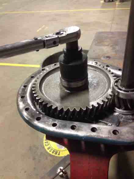

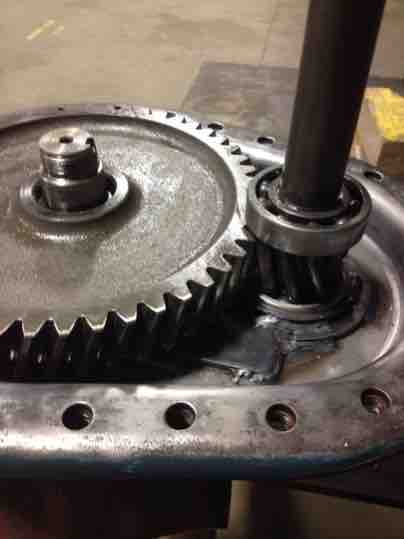

Then installed the gear along with axle shaft.
Note: mark the top of the gear BEFORE removing :eek: it save confusion when reinstalling ;)
Add your last copper washer and collar.
Then install the bearing
Then install the nut.
Note: torque spec on the nut is between 110 and 140 ft/lbs. I torqued to 140 ft/lbs
Don't forget to tap the divot on the nut back into the flat spot to lock it in the shaft :D
