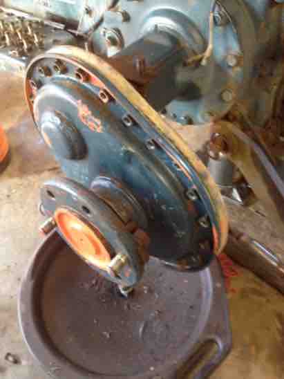

Nah, it took wayyyy longer to right the posts then it did to actually tear it down and reassemble it. Took less the five minutes to tear it down. Hardest part was scraping the bloody gasket. Took less then ten minutes to put it back together. Hopefully the tractor will be back up and running by six tonight :D

Wow, that's a lot of work! Makes me feel guilty after replacing the axle seals on my B7100- took maybe 12-15 mins per side. Jack it up, pull the wheel & hub, wipe, pry the old seal out, tap in the new one, re-assemble. I shall now consider myself blessed.
It would have been really nice if it was set up like yours :D I put it off for as long as I did because the fender bolts were so rusted and such a pain to get too :rolleyes: That was the hardest part about the tear down. I picked up a 17mm universal socket today. So installing it should be quite a bit easier :D:D

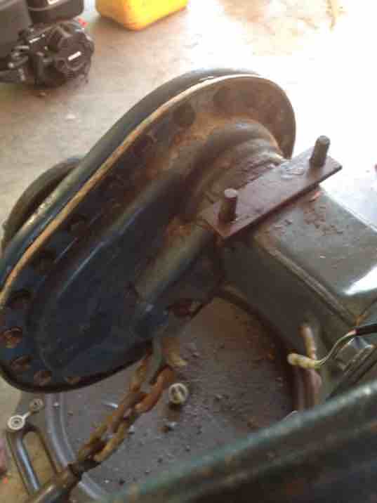

I wiped down the mating surface for the paper gasket with brake cleaner on a rag to get rid of any residue.
Then coated with a thin coating of ultra black rtv.
Smoothed it out.
Then used the rtv to hold the paper gasket in place ;)

Then reinstalling the case. You hold it up square with the opening. Ease it into place till you find the hole for the axle.
After finding the hole, rotate the housing till you feel the axle slide in the grooves.
Then rotate till the case lines up. Give it a wiggle as your working to two halves together. It will slide right in to place.
Then it's a matter of putting all the bolts back in and tightening them down.

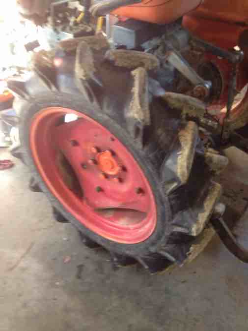

Then install your tire :D
Then it's just a matter of filling the oil back up and testing. :D

Just got done testing her out :D warmed her up for a bit, then ran her down the road for awhile, testing operation, and making sure I had everything correct. No leaks!!!!!! :D:D:cool:
