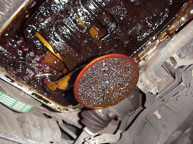

50,000 mile oil changes is abuse
It is only abuse when the engine fails. Until that time it is inexcusable ignorance of mechanics. It never ceases to amaze me that people will spend thousands of dollars on the purchase and then cheap out on oil and filter changes. I guess that it is only normal that people that can afford expensive tractors, trucks, or cars will neglect routine maintenance because they can afford to replace it when it fails.
