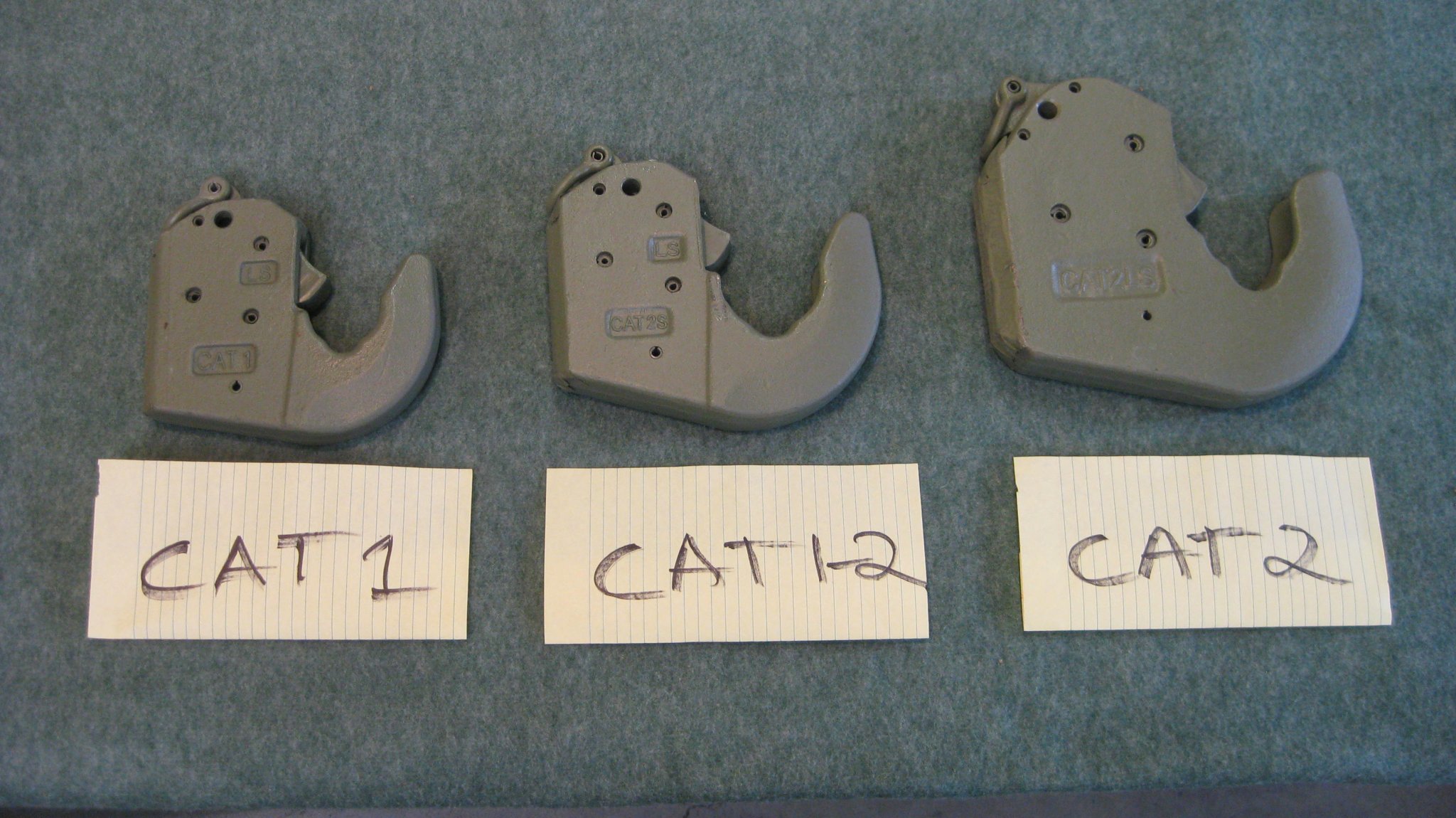

These are available as weld-on pieces.
They are available as pictured, cat 1, cat 1-2 or cat 2.
You would need the cat 1 units.
Euro quick hitch hooks are what I have always called them.

curious...found these..
seems simple to cut yours, weld these on,no need to buy another top link OR PTO shaft.
The only time that they would not add ANY length is if you have a straight draft link with no bends back at the implement connection point. I personally have NEVER seen such a draft link.
Based on the typical weld position of the draft link ball swivel, the Euro hooks will add 2 1/8" to the overall length. You can fudge that a small amount, but not 2" worth that I have seen and still have the hitch work as designed.
