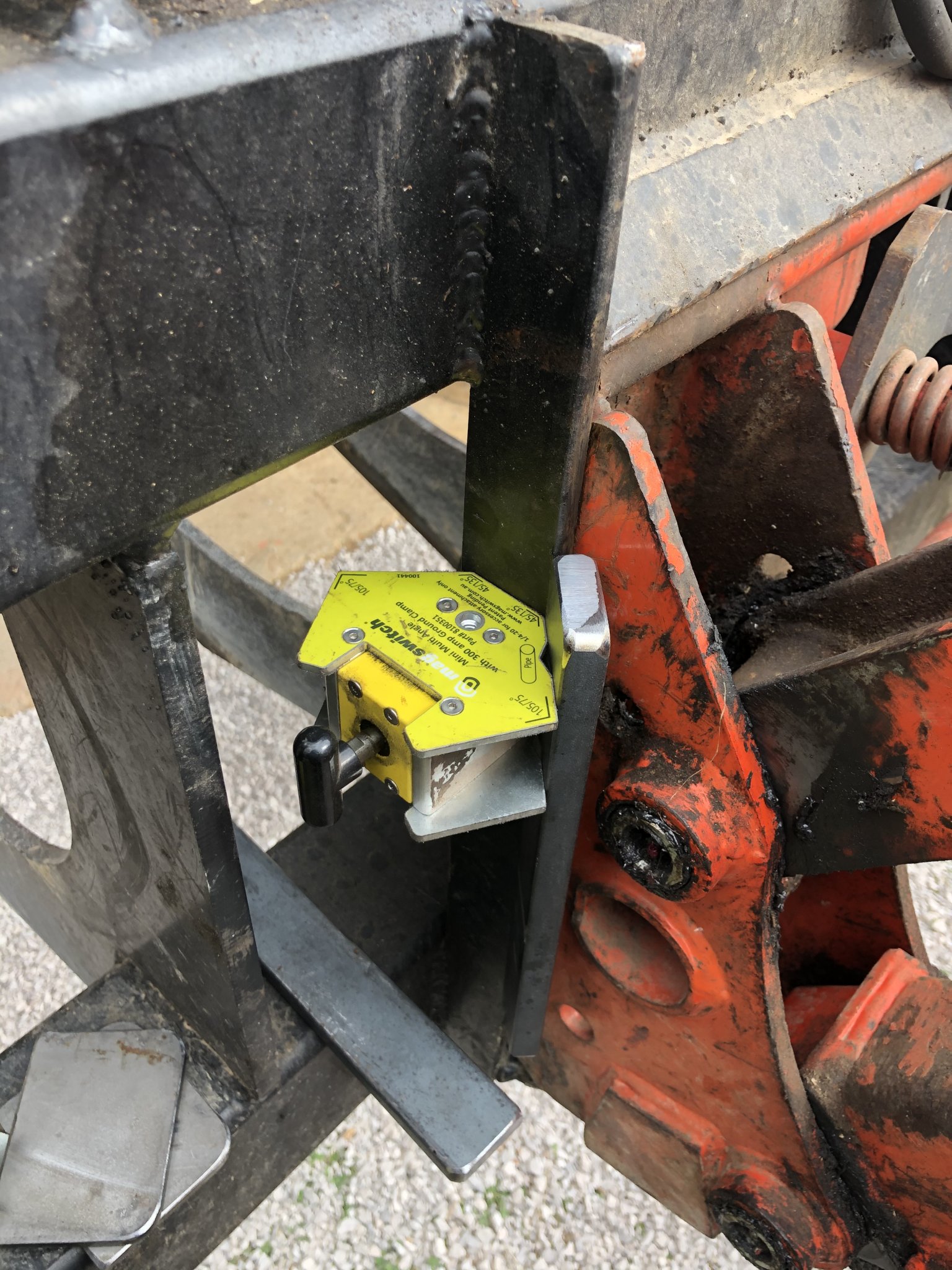

Todays update - I'm finished hacking up the bucket with the angle grinder. I had to cut back the reinforcing brace a bit:
Then put a cutout in the bottom 'lip' piece to accommodate the SSQA pin. It's 1/4 x 3" stock.
And here's the bucket with the bottom lip plate and reinforcement plates tack-welded up:

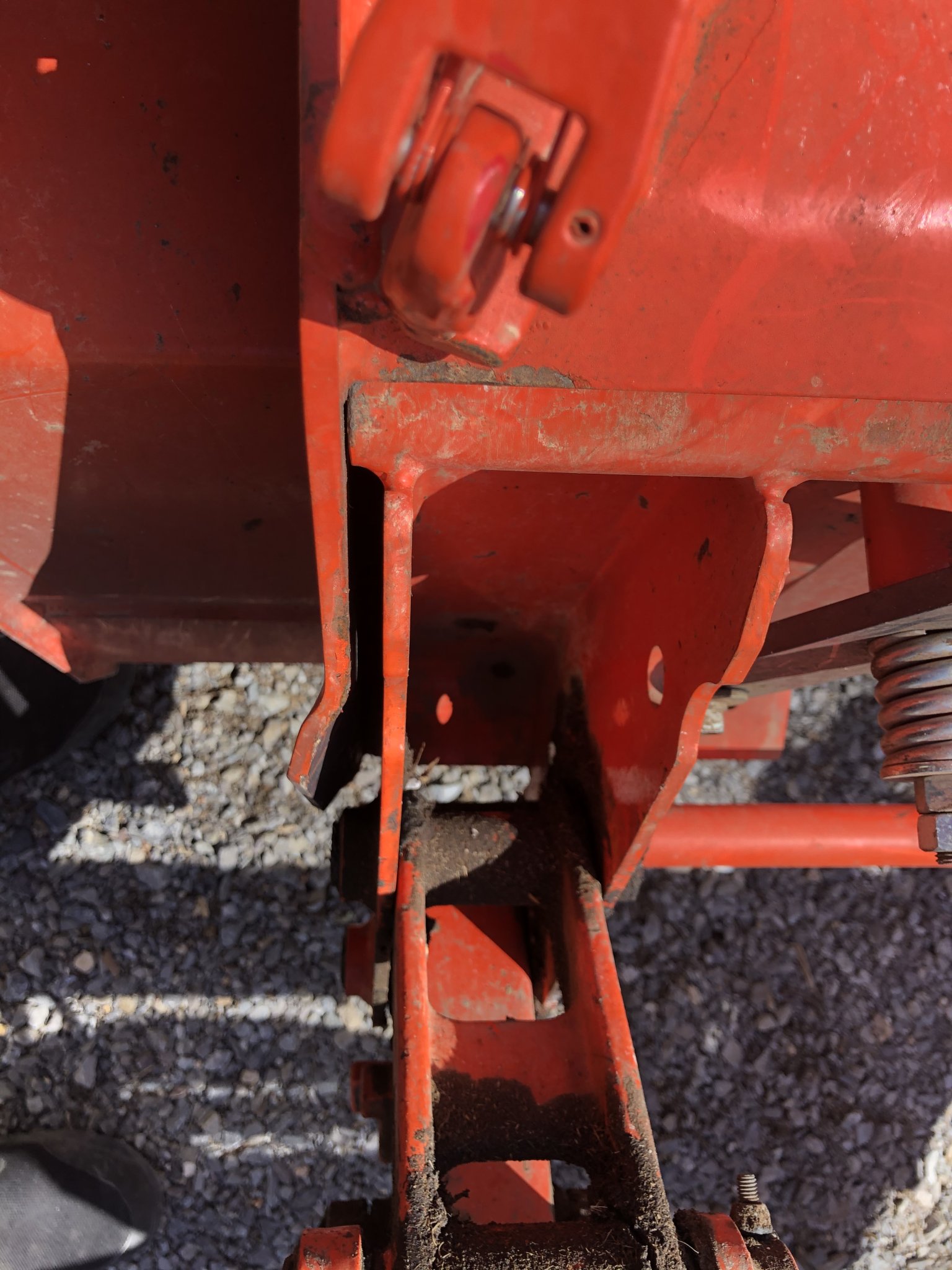

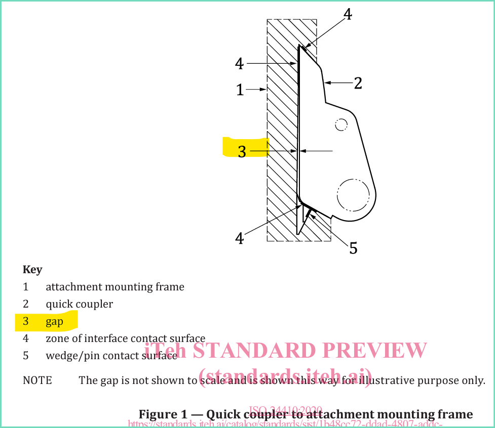

I put the bucket on the SSQA adapter, and it looks decent - no glaring issues, but there's some fine tuning needed to get the 'gap' between the back of the bucket and the front of the latch plate set properly. It looks like the ISO standard says there is supposed to be a gap, but I don't have access to the full spec and don't know what the gap ought to be.
You want the wedge pins to give tight fit with no play. See where paint has been contact between latchbox plates and bucket.

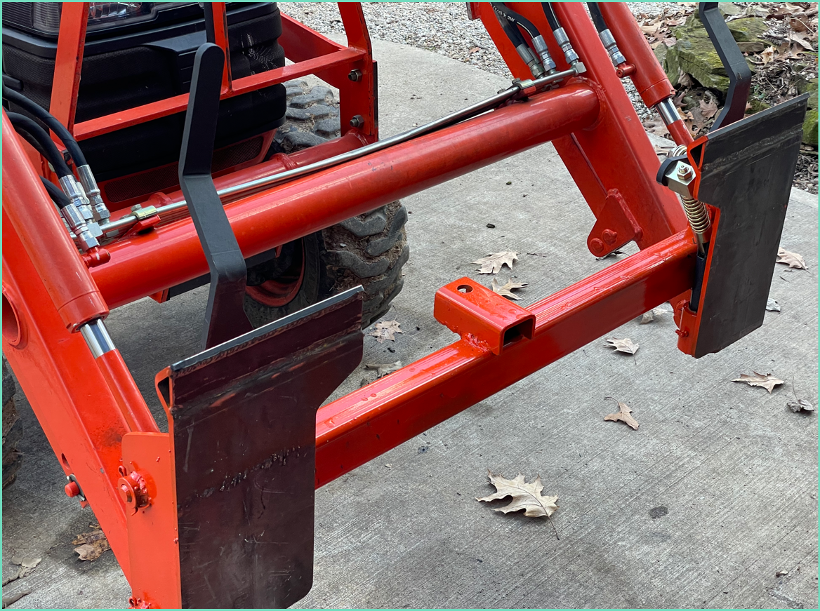

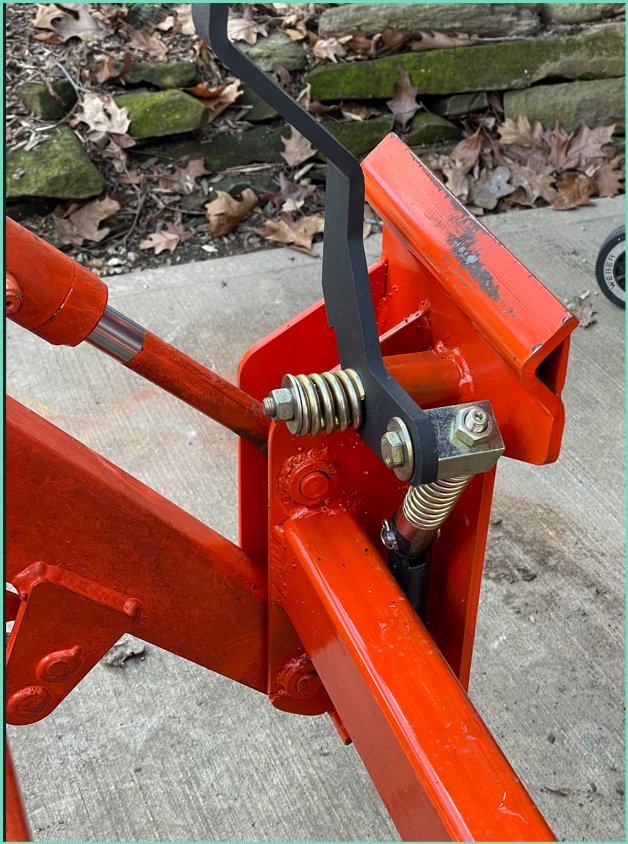

Pretty much wrapped this project up. Here's the latch plates on the tractor:

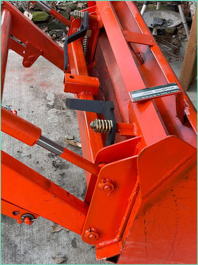

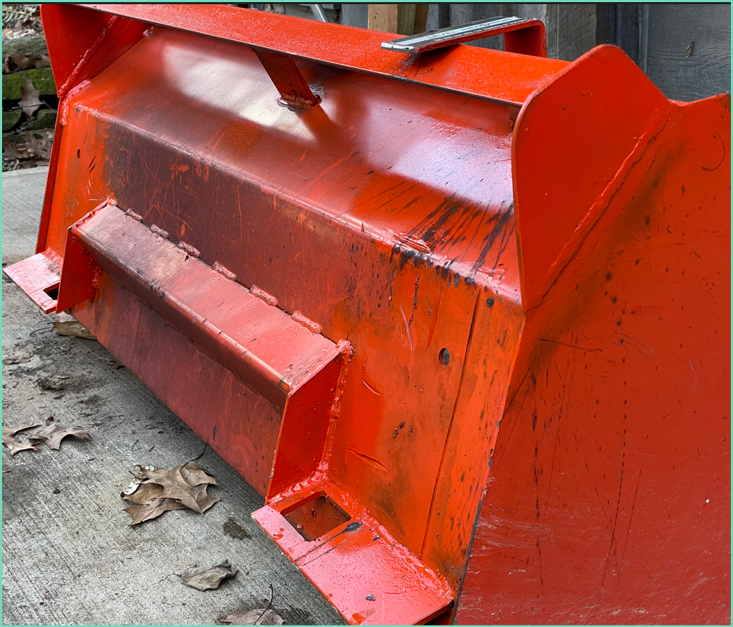

The modified bucket:

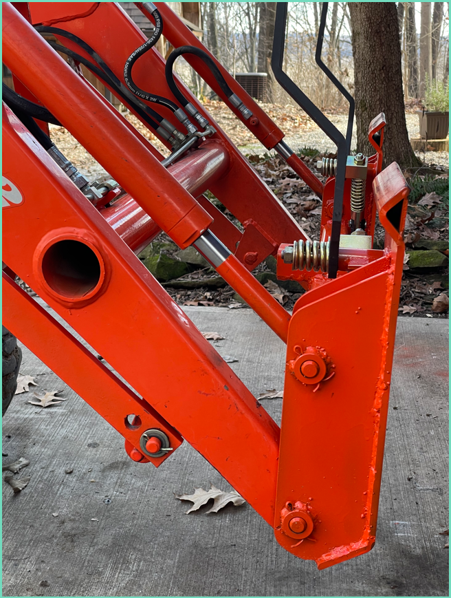

And both of them together:
I don't think I'd change too much, although I wished I'd have spent some time practicing my welding before tackling this - it's been a while since I did much MIG welding, and it shows! The latch plates I bought and showed in the first post are heavier than needed. They're made of 5/16 (8mm?) steel plate and for this application, add unnecessary weight - 1/4" construction would have been plenty stout.
In my opinion, the only 'critical' part of the project is getting the side plates (with the bushings that accept the pins) accurately located, and not having your welds distort them. I took baby steps, checking them often throughout the weld to be sure they stayed straight. Same goes for putting in the 2x3 cross member between the latch plates - make sure it doesn't create distortion that would knock the pin bushings out of whack.
I put a little 2" x 1.5" drawbar 'receiver' on the latch plate cross member - that way I can easily pop the drawbar out of the back of the tractor and put it, with a 2" ball, up front to move my little trailers around.
As I mentioned, the HF 6" grinder was a pleasant surprise. Fitted with a 1/16" cutoff wheel, it was super handy.
I still need to figure out the best way to grease the bottom pins - the zerks aren't accessible - I need to make an access hole on the bottom of the latch plates, I guess. Or maybe right-angle zerks.
