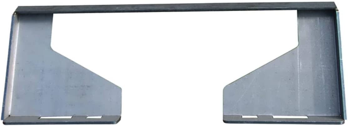

Does anyone here have a recommendation for a plate that will go on an LA681 bucket without too much cutting? I don't see any point in ordering an expensive one, since steel is steel. They are available in 3/8" for as little as $150, delivered.
Tractor Mike sells a plate that looks different from the ones on Amazon. His plate has two rectangles at the ends, with a big, empty rectangular space between them to allow keeping most of the angle-iron brace on the back of a Kubota bucket. The Titan plates on Amazon have smaller cutouts. I can cut more metal out, but I would like a plate which is as close to ideal as possible when it arrives.

Honestly a plate is a plate. If it doest really matter which one you get. I prefer the ones that you can weld in the middle of, but the solid one can have a hole cut in them just as quick.
28,685
5,111
Retro fits usually work better with full plates
But that's not a bad plate to work with.
9,904
4,059
You don't 'need' the material in the center, as the weight is on the loader frame 'arms'.
My plates are about 7" wide just to the locking pins, then I weld 'whatever' is needed between them.
You can fab a 'full' sheet style from a 24x48 sheet, cut in 3 , main is 16.5, then 3" top rail, 3" btm rail
more or less....

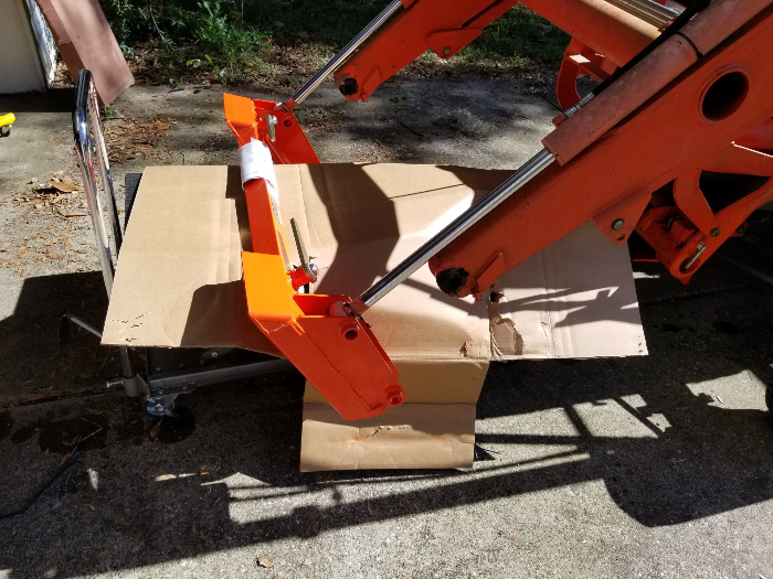

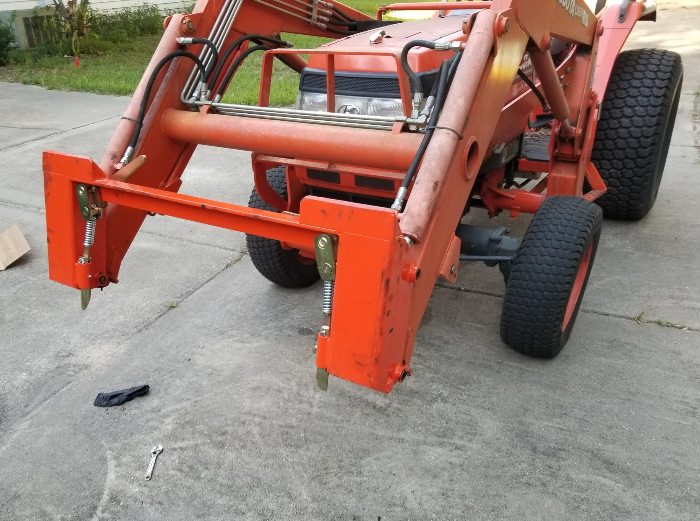

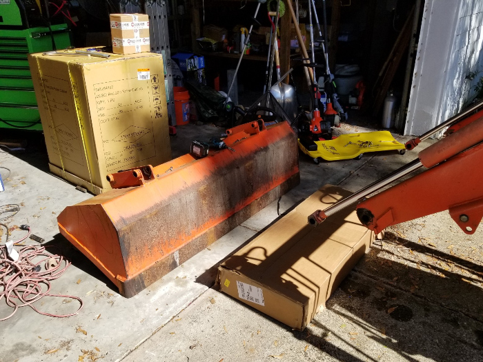

My ATI SSQA and Titan 3/8" solid mount plate arrived, and today I installed the adaptor.
Taking the bucket off the tractor wasn't too bad. The bolts on the pins were pretty fresh, so the nuts came right off. I put the bucket down on a couple of cinder blocks.
Putting the adaptor on the tractor was not all that much fun. I decided it was smarter to move the part to the tractor instead of trying to nudge the tractor to the part to make it line up, so I put the adaptor on a Harbor Freight lift table. That was a great idea, but unfortunately, I decided to line up holes on the hydraulics first instead of the rigid FEL holes. After wasting maybe an hour in the burning sun, I started over, installing the pins on the arms first. After that, the job was merely unpleasant, not terrible.
ATI does not leave enough room to put a socket wrench on the pin bolts, and the Kubota bolts are ridiculously long, so I had a lot of fun turning slippery bolts with a box wrench.
I have seen people complain about the condition of their old pins when installing things, but mine looked very good. The tractor has about 1200 hours. I grease it pretty regularly, but I don't recall seeing the zerks in the pins before, so they have probably not been greased since 2017.
I had to use a rawhide hammer, three different drive punches to line the pin holes up, and a massive Nupla deadblow hammer. I can see why people hate old-style pin attachments. I could see spending three hours switching attachments the old way.
The mount plate I ordered feels like it weighs over a hundred pounds. I think about 70 pounds will be cut out and set aside, so I wasted some money there, but maybe I can use the scrap to make mount plates for the fork attachment I'm going to build.
The black marks in the photos are pin grease, which I got all over everything.
The tractor is leaking hydraulic fluid somewhere between the front wheels, so I have to figure that out.
Really looking forward to using multiple attachments instead of being crippled by my brush forks.
