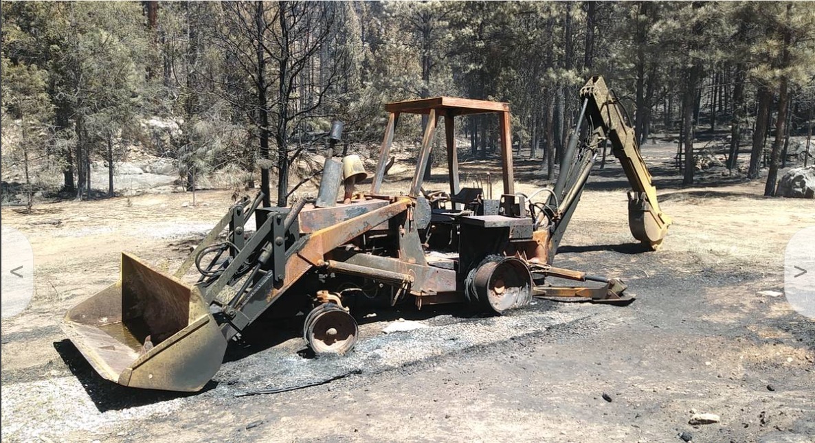

Did it look like this?
This was burned in the Tinder Fire in northern AZ a few years back, but your post reminded me of it.

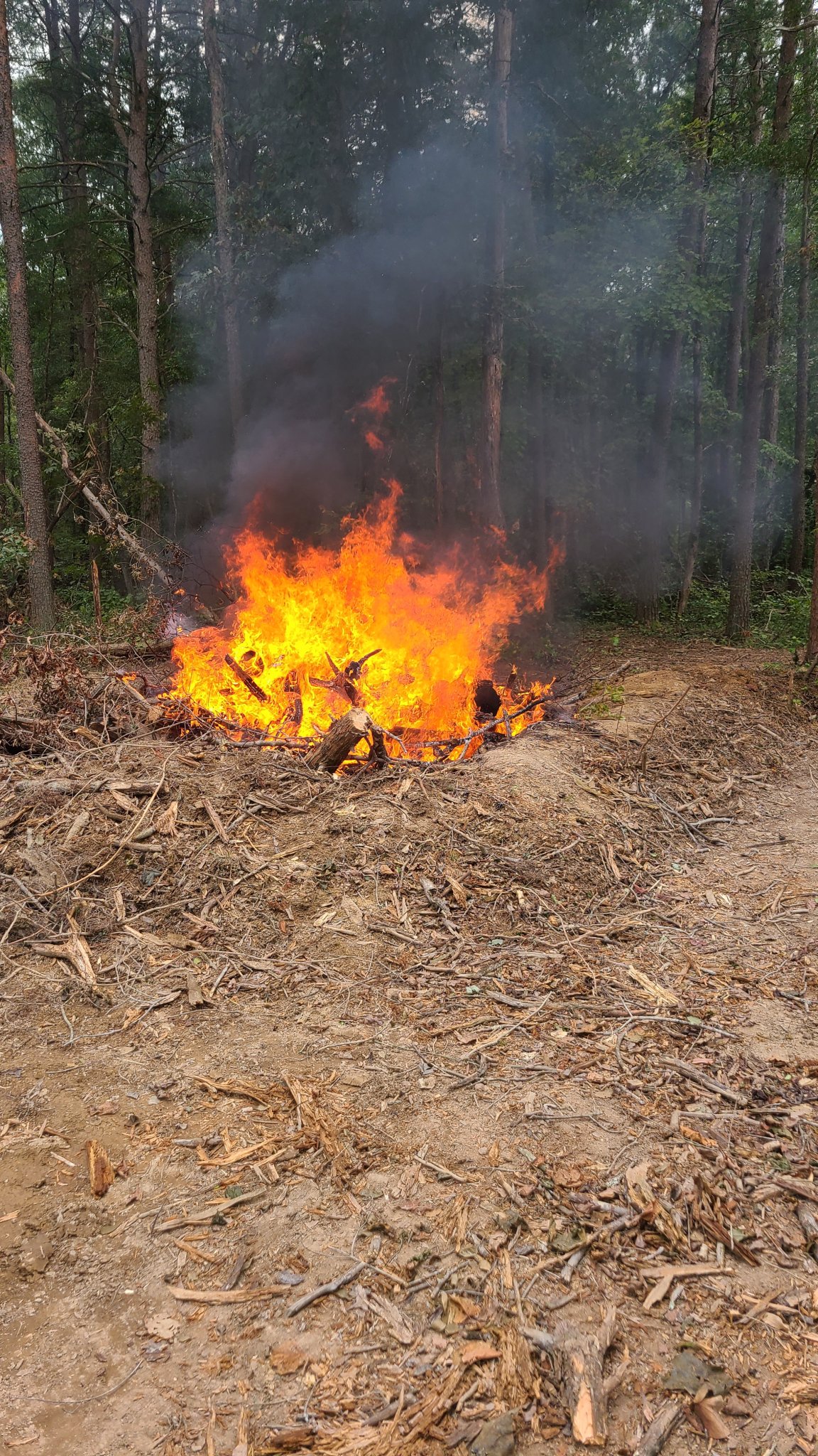

For me, the reasons are three fold:
I can burn in higher winds without the breeze carrying larger embers. 20 mph gusts don't affect the fire.
When I'm done in that location, I can bury the remnants and move to a new location (lots of old dead/ downed trees on our property).
Easier to extinguish should it get out of control. Just bulldoze the dirt back in.
This one is about 10' in diameter and 5' deep.

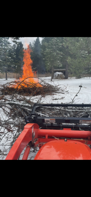

I use my grapple all the time to feed the fire pit. I have 3 separate burn pit/pile areas depending on where I am on the property. There all dug out almost 2 feet deep about 10x10’ across. I burn huge piles of branches, brush and pine logs etc every year. Once the pile is going, I grapple a large pile, ( from 100+ feet away) if there’s any wind, I’ll be on the correct side of it. ( not in my face) I drop the brush 20’ out, then use the grapple top fingers like your hand, and push into the fire pit, keeping tires, hoses etc away from the fairly small fire. It’s like flicking your fingers towards the fire.
I wouldnt feed it if it was so hot I didn’t want to be near the fire. A little common sense goes a long way.

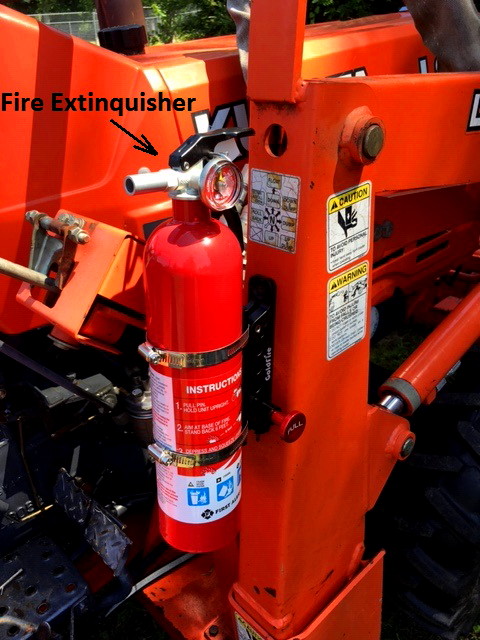

I have mine ON the tractor and in every vehicle. (y)
That looks like a little 2-1/2 pounder!
If you have ever have a fuel fire that may not be enough.
I lost an entire house due to an insufficient extinguisher capacity, fighting a Gravely mower fire.
I keep a 5 Lb. dry chemical extinguisher on my Kubota TLB.
Also: remove that extinguisher from it's bracket every 6 to 12 months, turn it upside down and smack it a few times with a short length of 2 x 4...... to break up the settled power.
