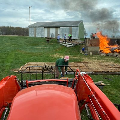

This pic doesn’t show it but if you have forks I have had good luck getting relatively close to fire, dump forks, and as the object gets to the end of the forks, quickly curl back! Sounds crazy but you can “flip” the object quite a ways and onto the fire.

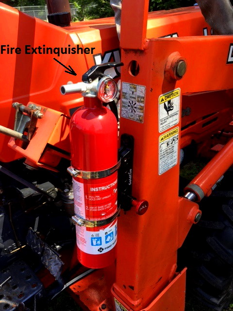

I would have a large newly charged fire extinguisher nearby the tractor. I assume the hood is flammable to some degree and would worry about it catching fire

I failed to mention that I do have a fire extinguisher on the ATV nearby. Always have a backup plan. 👍

Will your little 5BC extinguisher take care of a fire that involves your tractor, 50 lbs of rubber tires, 8 qts of oil, and 15 gals of diesel fuel…??? I doubt it.
I suggest you keep your tractor out of the fire and don’t use it for what it was never intended. Coots and Boots and Red Adair use specialized bulldozers for that task.

After being a firefighter for 38 years, if dirt is available, I would take a shovel over a very limited fire extinguisher any time.
