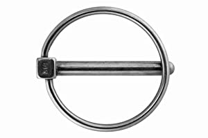

How about drilling the hole out enough to fit the smallest size lynch pin? (I think that 3/16" is available) Lynch pins are used on a lot of three point attachments. As you know, they go on and off easily.

That's probably the route I will take. Of course, I will procrastinate until I need to put the 3 Point arms on again and not have it done. 😁

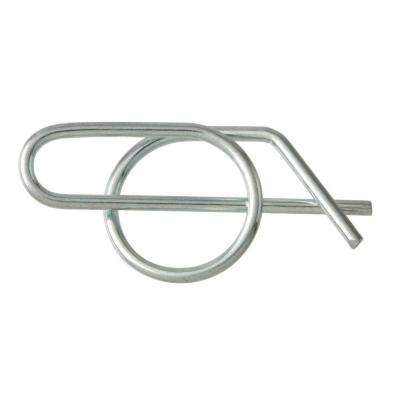

'R' pins, first pic by Ford , is what I've used for decades and as long as they're properly sized and neversiezed, will work fine for years.
lawnmower deck ones rot out due to wet grass,no oil and LOTS of vibration.
hint: run a length of 'paracord' through the eye and gently pull the cord, pin comes out and NO bandaids required !

I have drilled out several pins to fit the snap ring pins, never had a problem. Usually takes just a slight increase in the hole size. Makes thing so much easier.

OK, I stopped by Harbor Freight today and decided to buy an assorted box of hitch pins. The 5/32 pins fit perfectly. I'll probably use those for now. They should be fine as I don't use the 3-point hitch often.
