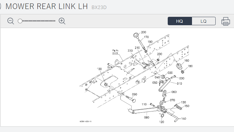

The BX23 is a clone of the BX22, and having had a BX22, with the mower deck, I can tell you factually that the mower deck will not stay locked in the upper position even when you have the selector knob in the "Top" position. There is no way to separate the action of the 3-point arms from the mid-mount mower. The owner's manual instructs you to remove the backhoe when using the mid-mount mower. It also instructs you to remove the mid-mount mower when using the 3-point hitch for other implements. I used to mow with my BX22 while leaving the loader on since it was such a pain to remove it. After having the mid-mount mower on during the summer, and also wanting to do loader work that many times would require having to remove the mid-mount mower, I realized that a machine that was dedicated to mowing was a better solution. I purchased a ZTR mower, and it is a faster and more efficient way to mow lawns. When I sold the BX22, I gave the new purchaser the mid-mount mower since I would never use it again having learned the hard way that it isn't an efficient way to cut grass. The only way that I would ever use a BX tractor as a stand-alone mower is if both the backhoe and the loader were removed. I also had a BX grass catcher, and it was just about useless. The 60" mower deck would fill the 3 bags quite quickly and I was constantly emptying it. For that reason alone, I switched to Oregon Gator Mulching blades and stopped collecting the clippings. I also got quite adept at removing and reinstalling the mower deck until I got the ZTR. I now have a BX23S, and in many ways, I still like the BX22 better than the BX23S. All the safety switches drive me crazy, and the fact that they set the tractor idle as 12 or 1400 RPM is another bone of contention for me. My BX22 would idle at 600 RPM, and it didn't sound like it was screaming every time I had to get off the machine to remove a branch or some other object that I didn't want to run over when cutting grass.
33,375
8,694
It's a matter of semantics, I suppose. The PTO selector lever controls which PTO will spin. I understand that. At the same time, in my mind, the lift/lower lever works in conjunction as to which PTO has been selected and the implement attached to that PTO will operate. Eg., If the mower is used, select the MM PTO; using the lift lever, the mower will move up or down and the blades will turn when the control lever is pushed forward and down. Conversely, if the rear PTO is selected, the lift lever should raise/lower the 3 pt arms only, not the MMM. The blades do not turn but the mower continues to move up/down in tandem with the 3 pt arms.
I have raised the mower to its full height and have been able to turn the knob to get it to the highest point. I was glad to learn that the mower had to be at the full height in order for that knob to turn. But, it doesn't seem to "lock" there. Is there something else that needs to be done when the "top" indicator is selected with the mower knob below the seat?
When I select the PTO for the rear, the 3 pt lift arms move up and down but so does the mower at the same time. I did not expect to have to remove the mower to be able to use rear implements. I want to use a box blade right now but the mower will drag, I would think...or even get a pile of dirt underneath.
And, yes, I have pored over the operator's manual for the mower. Very little info is given and certainly nothing that helps solve this issue. That's why I came to the pros! I hope you don't let me down!
TG
Yea that thinking is all in your mind, the system does not work that way.
No matter which position you have the PTO ( Power Take Off ) in the three point will operate.
and thusly also the MMM until it's locked in the up right position.
This model the lock is manual, see last pic lock in yellow.
First lift the mower, this might involve setting the selector to max height.
Then turn the pin 1/4 turn to disengage it and allow it to lock into the frame.
Now only the three point will move and the MMM will stay up.
Then to disengage the lock, lift the three point to max. pull pin turn 1/4 turn to lock open, now MMM will work with three point.

The yellow indicator is not showing (that I can see) but I've looked at both the RH and LH diagrams. There is a pin on each side so I think that's what you're indicating. I'll give it a try. My main computer is not working so if I can't fully see, I'll download the BX23D from kubotabooks and look more closely. I hope this works. I know you know these machines through and through. Thanks for your help.

Good news. The 1/4 turn of the pin did not solve the problem...unless I was turning the wrong pin. There are not a lot of choices of pins so I don't think that was the problem.
BUT, I raised the deck as far as I could manually and blocked it at its highest. Then, I turned the height adjustment knob several times in both directions. I could feel the little bumps as I turned. Then, I took the blocks out to let the mower hang on its own. Then, I raised the mower to the highest point and turned the height adjustment knob as far toward TOP as I could. It stopped but not at TOP. When I selected for the rear PTO only and used the raise/lower lever, the mower stayed put at the top while the rear arms moved up and down. Problem solved.
I am not certain of the actual solution but 85Hokie's suggestion was what has worked. Why it didn't in the past, I do not know. And, who cares? It is working and I can now proceed to find other problems to deal with on this tractor. The prior owner did not care for this one very well so, little by little, it is coming back to the machine it needs to be. Well, at least becoming the machine I need it to be.

I had the same issue with the Cutter Knob not being able to be placed into the "TOP" position - the advice I got was as follows:
"The height adjustment "Top" position holds the deck in the fully raised position regardless of the 3 point hitch position. Raise the deck completely and turn the height adjustment to "Top". If the knob won't turn to "Top", do the following:
Looking at the rear of the tractor, just inside the left rear tire is a linkage that controls the lift. There will be a gold colored bolt that faces rearward. Loosen the lock nut on the bolt and screw the bolt in one turn. Raise the mmm all the way and see if the knob will turn to the "Top" position. If not, turn the bolt another turn and try again. It shouldn't take more than a few turns of the bolt unless something else is out of adjustment."

I don’t see any yellow highlighted pin either but I’m pretty sure it’s the #140 pin
@North Idaho Wolfman may come back to confirm that.
I imagine that the mower deck has to be accurately adjusted for the pin to align with the hole.
You might be able to see the hole in a bracket that appears to be welded to the tractor frame.

Yes, I thought the pin was #140 as well. There is no hole. There is a spring with a roll pin holding the spring in place. I think pulling that pin would release the mower deck! Not sure. TopK gave another good explanation so I'll check into that, as well as to look at #140 a little closer. It's too hot to do any more today. Perhaps next week.
