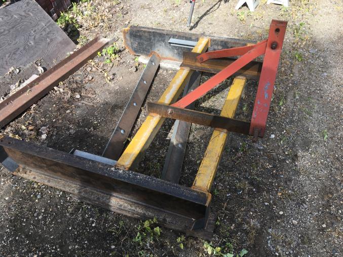

Here's a few pics of the land plane I built. I robbed the cutting edges and the hitch set up off of my 5 foot box blade and used those pieces to build a land plane. I can bolt the pieces back on the box blade if and when I need to use that implement again. The land plane works wonders on my gravel road and large parking area and pulls as easy as can be. I had some scrap heavy channel iron that I used for the sides of the plane and a couple of pieces of angle iron as mounts for the cutting edges. The pics kind of explain themselves. Next will be to sandblast it and paint it Kubota orange.

I’ll second using a land plane. It planes the surface and redistributes the material into the low spots, by altering your path , side to side, then front to back, even on a diagonal you will do a great leveling job.
Look at how an Auto body tech straightens a dented panel to make it smooth as glass. Going at it from all directions makes it smooth
