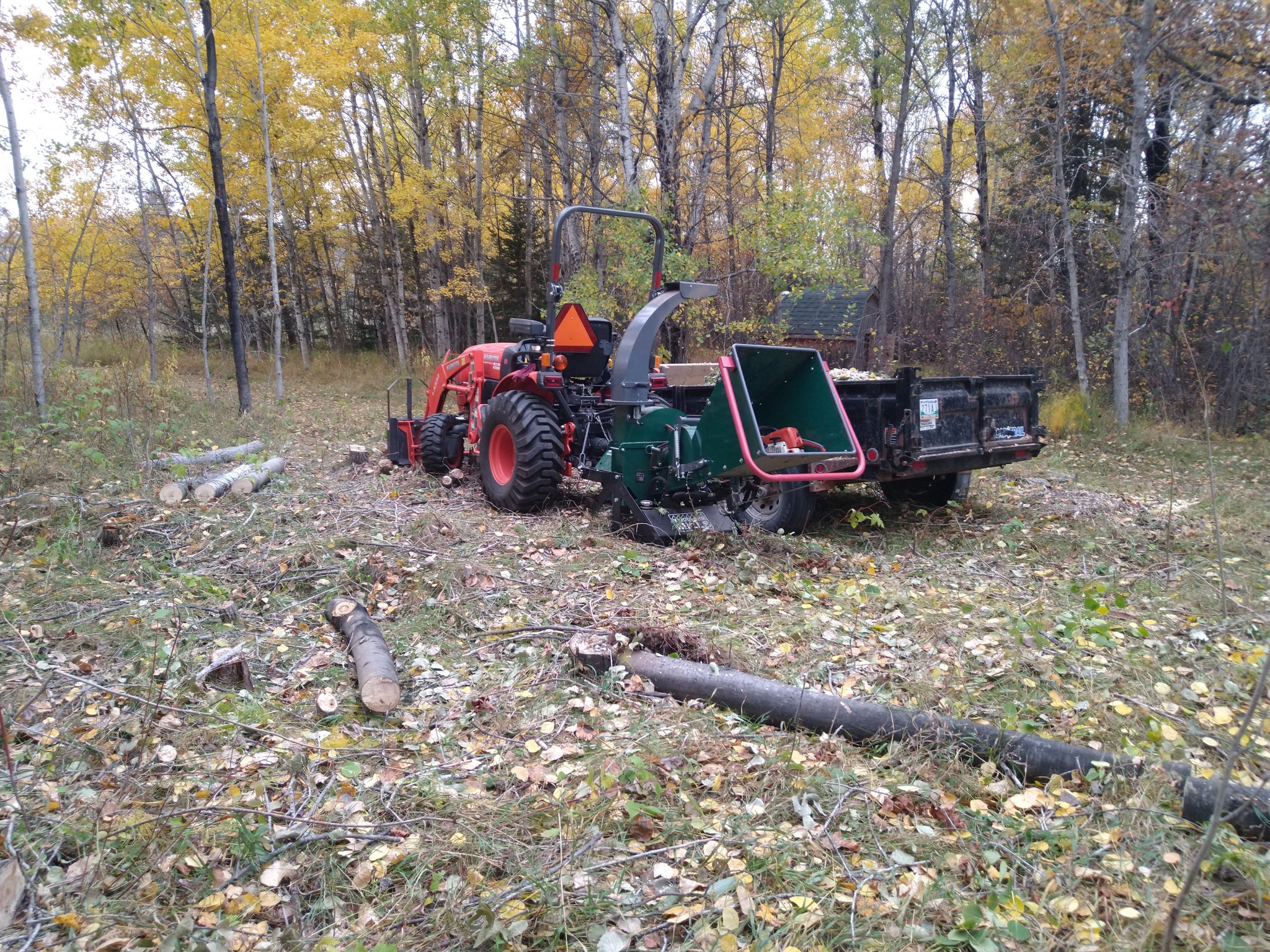

My tractor hp is at the bottom of the range for the WC68 so anything larger would be a waste and probably harmful to my tractor imo.
Much over 4" depending on the wood will over tax the tractor anyway. The way I see it, this chipper should last a very long time.
The variable-rate hydraulic infeed is quite good at pulling branches and tree tops through, and if it stalls i can usually give the wood a nudge and off it goes. By now I know pretty well what won't make it, and trim those branches.
But it's very satisfying when you lift a 4" at the base 30 ft long poplar tree up into the chute and it gets grabbed and the whole thing goes through. Lots of time to scope out the next load.
