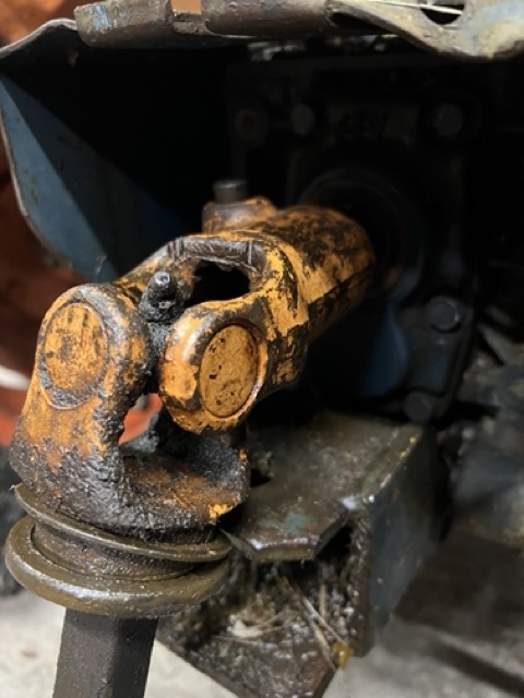

Hi,
Fist experience with a tractor here. Recently purchased a 1977 Kubota B7100D with a Woods RM42 attached. When I tried to remove the mower for the winter the PTO shaft did not want to come off. Previous owner said that he had it off last winter. At first I couldn't get the pin to move but after lots of PB Blaster it moves freely. I pushed in the pin and tried to pull the shaft off with my hands but it would not move. I then took a ratchet strap, went around a tree and tried to ratchet it off while holding the pin in with a clamp. It wouldn't move. Anyone have any tricks to get it off. I have sprayed it down with lots of PB Blaster and WD-40 Rust Penetrator. Thanks.

Rig up that ratchet strap again and give the shaft a tappity tap tap with a hammer while under tension. Lube will help too.

Keep soaking. tap it both in the on and off directions. That might help get it moving. Make sure the pin is nice and free - and fully depressed.

As others have mentioned the pin may be what is not releasing. Soak the pin with the solvent and tap lightly with a small wrench or hammer to free it up internally. It should pull off with very little force.
You might try to push the shaft forward and then back. It will only move a slight amount, but it may free up what is lodged there.

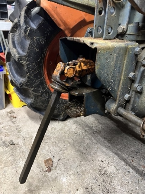

It appears to have been hit with a chisel a few times on the top side in the second photo, not a good tool to use. Have you ran it at all since you have had it? If not maybe that would loosen it a little if it has been sitting and not used for a long time.
I wonder if you could make a puller with a piece of bar stock to go thru the ujoint and with some threaded rod on each side pushing against the tractor get it to move, making sure the release pin is pushed. Some of the pins will come out if you remove a clip on the opposite side from the push part.

be nice to remove the PTO shield so you could have good ACCESS to it !
some compressed air to blow the crud away might help, then more 'degreaser', brake cleaner', more air...especially on the splines( get to them from the end.
sadly few actually remove,clean, lube, reinstall PTO shafts on 'one purpose' equipment making it 'fun' for the next guy
Patience, cleaner, good eyeballs......
..it'll come off

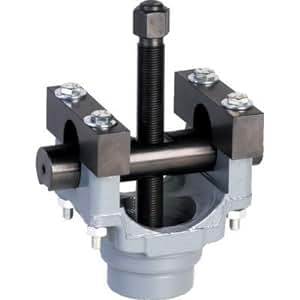

If you get tired of it take the ujoint apart and see if you can make/borrow/rent a puller. Picture for concept.
A jaw type might work if you can get the jaws behind it
^^^^^^^This^^^^^^
That will pull on the joint only, and not the PTO shaft and the whole tractor.
That is the idea I was saying with a bar going thru the assembled joint. It would have to go in the second side or remove the grease fitting and all thread used back to the tractor.
A bearing splitter behind the backside might work if you don't clamp it tight to the spline, again with a pusher bolt both sides,
As u say dis-assembling the joint might be the best way but if you can get the lock pin and spring out too would insure that wasn't hanging up.
edit. I see my flaw would be pulling on the whole shaft same as a strap. This puller against the shaft might be the best if it is stuck hard.
That would be awesome if the yoke had bolt-on caps like that. Crosses and caps are a pain in the @$$ to swap out even under the most ideal conditions, let alone trying to beat them apart without damaging anything on the tractor end.
