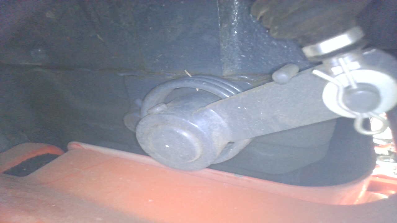

Thus it might need a slight PTO cable adjustment.
This will pull the cam away from the other side to help it from statically spinning.

Thank you for all your replies—it about has to be the cable adjustment NIW mentioned. I keep the spring area at the other end of the selector clean and oiled up pretty good. Wasn’t sure though if it was an ‘all or nothing’ engagement. NIW—and yup, it’s had two fluid changes so far, and was about 70 deg F outside when I observed it happening.

Pull the hair pin and pull the cable and see if it stops, if it does then an adjustment might be necessary.
