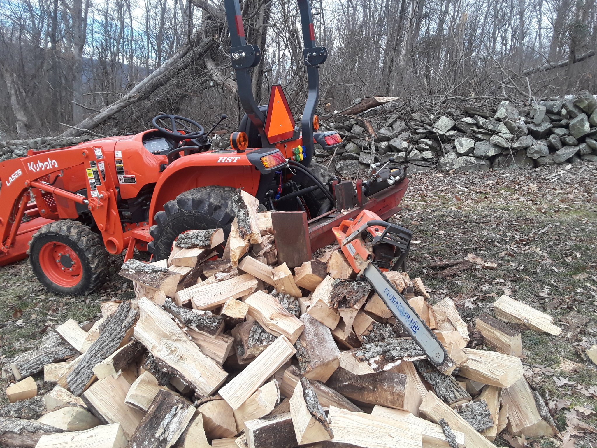

Well - now you have done it. Your picture features a Husqvarna chainsaw; the chainsaw brand argument cannot be far behind. :LOL:
As a Stihl owner (clearly the best saw - :ROFLMAO:), I do not judge others.
