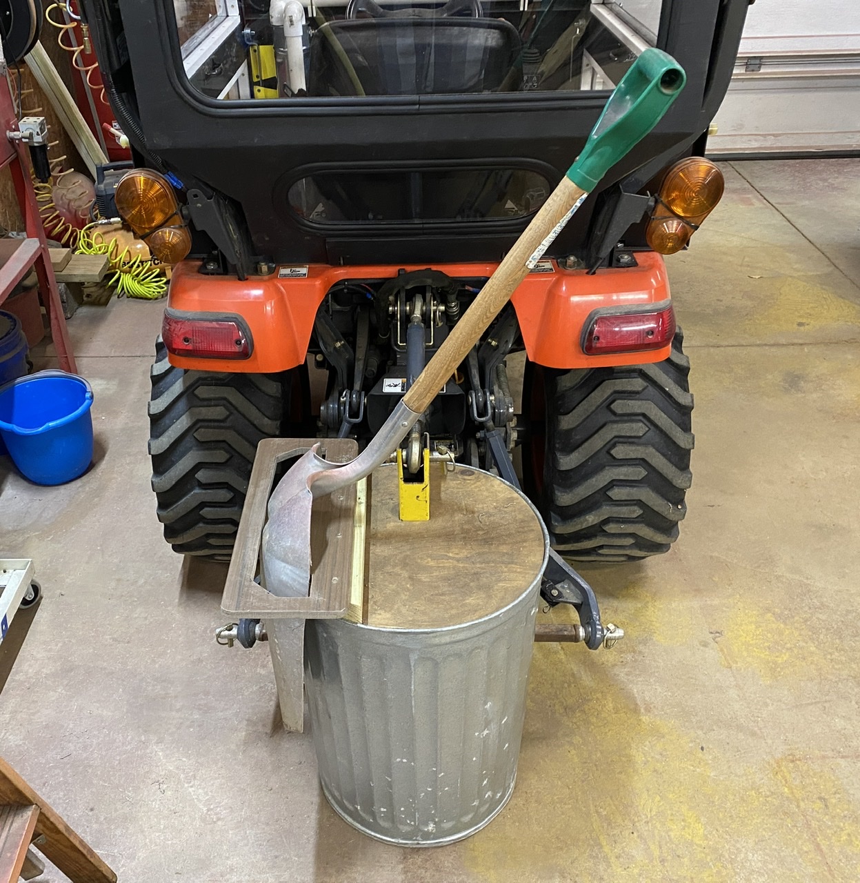

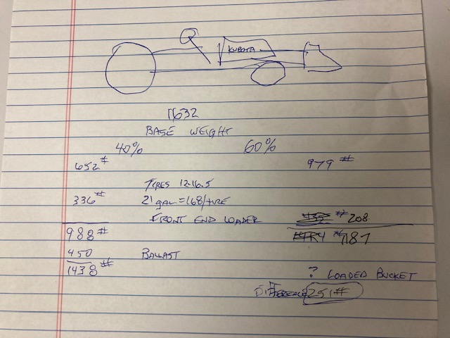

I have a B2601 and went through the same questions. I ended up with a ballast unit that weighs approximately 450# and has multiple tubes for tools, a trailer hitch, scabbards for 2 chains saws, chain hooks and a box for miscellaneous tools.
I used the base weights as shown in the owner's manual and tried to find the ballance point
then I figured concrete weights and decided that a 20 gallon trash can was perfect for about 450#. this is the final product.
I have used it with gravel and dirt and the weight seems right for my 54" bucket.
Hope this helps
Vann
Reactions: 7 users
5,955
3,166
then I figured concrete weights and decided that a 20 gallon trash can was perfect for about 450#. this is the final product. View attachment 90299
Hope this helps
Vann

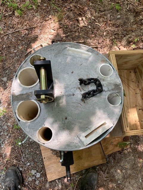

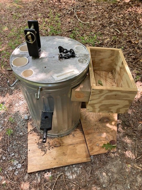

Good question!
There are definitely drain holes in the bottom of each pvc tube.
I also kept the trash can lid and cut a slot out for the top link. the slot is covered with a piece of old tire inner tube so not much rain will get in regardless of the drains being there.
Vann
