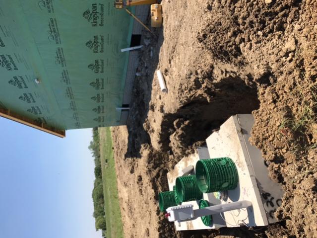

They are secured to the tank with a collar that goes over the riser pinching the butyl seal between the riser and the concrete and held there with screws. You can stack them to varying heights and I believe mix/match heights to get what you need. The tops are held on with 8 or 10 screws and the lid has a seal as well.
Did not think of taking any photo's closer than these
