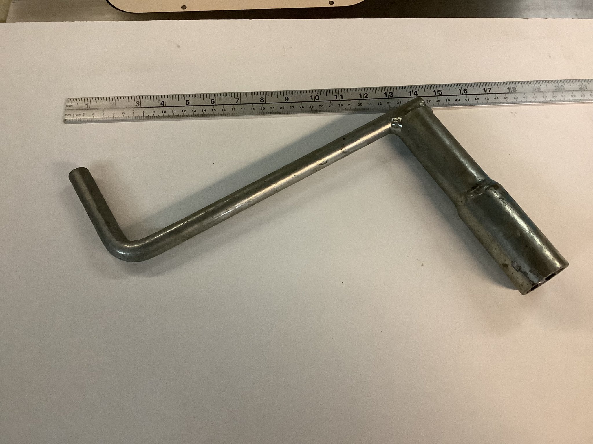

All Kubota tractors that are equipped with a PTO clutch utilize a spring-actuated brake. When there is no hydraulic pressure to engage the PTO clutch (Off Position), the spring or springs apply the PTO brake. When hydraulic pressure is sent to the PTO clutch, as it compresses the clutch to engage the PTO, pins from the piston also press against the brake plate overpowering the brake apply springs which releases the PTO brake.
The shaft can not turn with the PTO in the Off position because of the brake until the PTO shaft selector is shifted to Mid Only for turning the Rear shaft and Rear Only for turning the Midshaft.
Most Kubotas with PTO clutch brakes have a gap that allows the clutch to be rotated several degrees backwards to allow spline alinement. Instead of some fancy tool, I just use a 12" pair of slip joint pliers on the shaft for spline alinement.

On the LX2610 when the PTO selector is set to mid I have been told that it is possible to manually rotate the rear PTO shaft from the tractor so that it may be aligned with the splines of a PTO shaft for shaft attachment. However, before being told that the rear tractor PTO tractor shaft could be rotated when the mid PTO is selected, I would have said that it cannot. It certainly cannot be rotated readily by hand. Short of starting, spinning rear tractor PTO shaft, shutting down, and hoping for the appropriate alignment, rinse, repeat has anyone come up with a tool to rotate the shaft just a little to align the splines? No this isn't a problem if the implement allows for PTO shaft rotation, but some do not. What I was starting to think about was obtaining one of the PTO shaft extenders from Tractor Supply or equivalent and using a breaker bar or pipe wrench to turn it - or something of the sort. Then I thought, many others aren't first time tractor owners like me and someone must have solved this problem. All help appreciated, and thank you.
