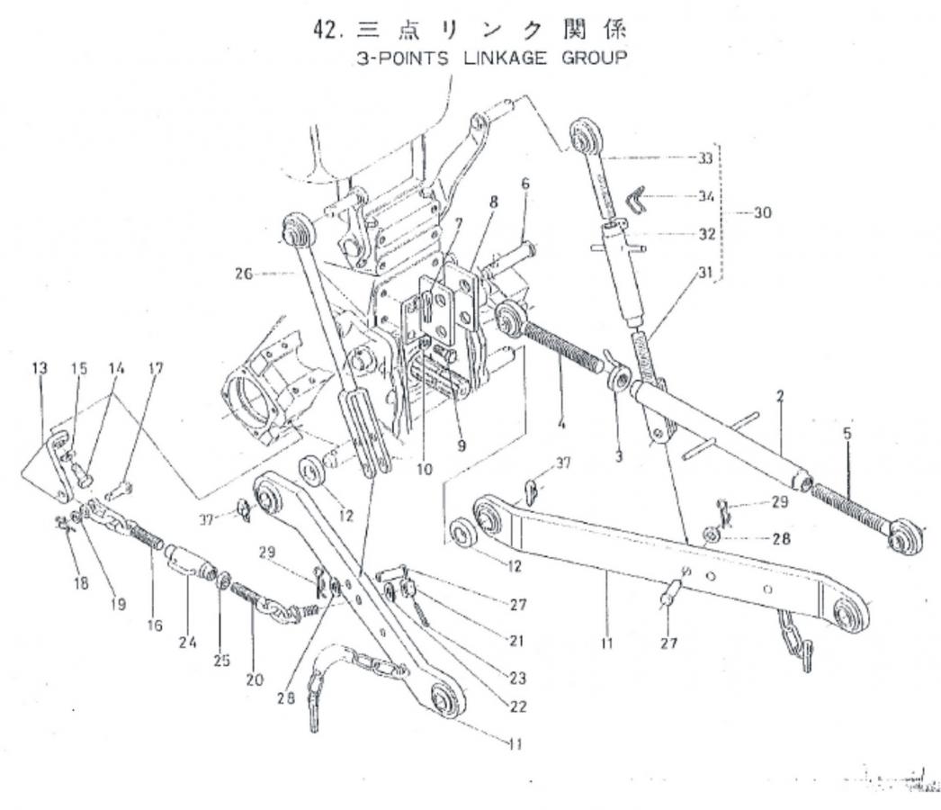

This is the top link bracket shown in the parts book

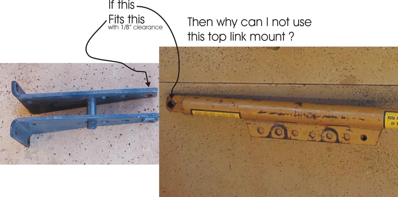

And this is my top link bracket, are you saying it is too long?
Even though there are three sets of holes at the end and one close to the rear end?

Yes your top link bracket is wrong for a PHD.
The main tube is too big and wide to fit into the middle of your bracket.
In order for you to use a PHD you'll need to get a L175 top link holder.

OR, shorten the one I have?
Still a bit confused, this is the L1500 Top Link (in parts book), looks identical to the L175

The brackets that you have on your L1500 were made exclusively for the rice patty rototiller that was made for it. ;)

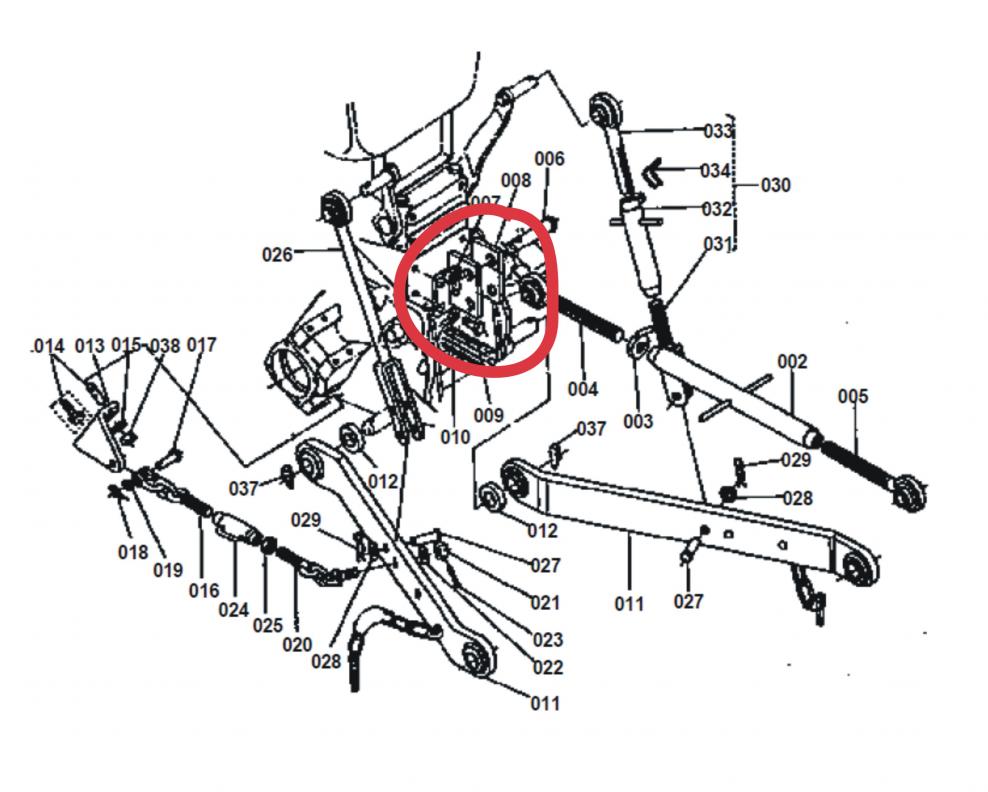

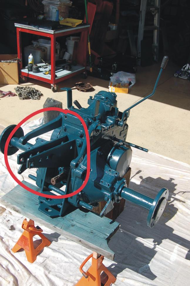

The current bracket won't exactly match the L175 bracket even if cut down, but it might still work. The L175 bracket mounts to the top 4 holes on the back of your trans housing. The 12" bracket mounts just below that. I had the same bracket that you had. I'm still looking for one from an L175. I'm currently running one from an L245 that had to be ground down in order to fit.

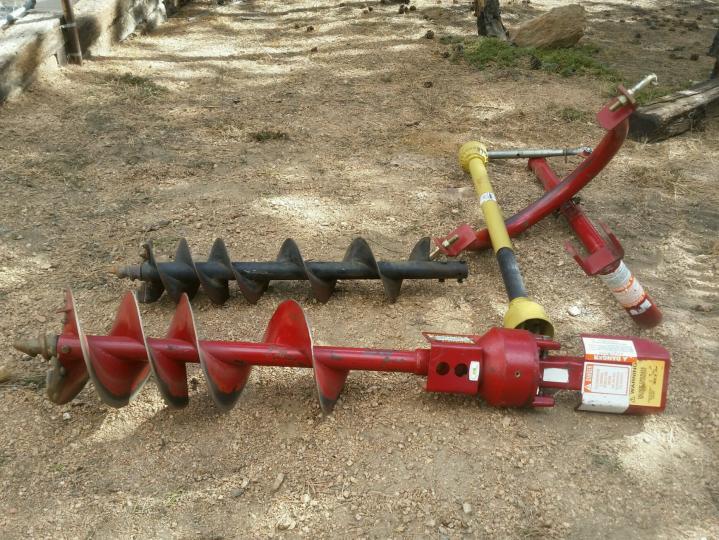

Now that I have a PHD I am still a bit confused :confused:
A picture is.......
you know the rest;
What is the big difference of 10" or so of the mounting location of the main tube (support) on the rear end of the tractor, with 7 choices for the A-Frame mount (which I have to fabricate) (missing)?
